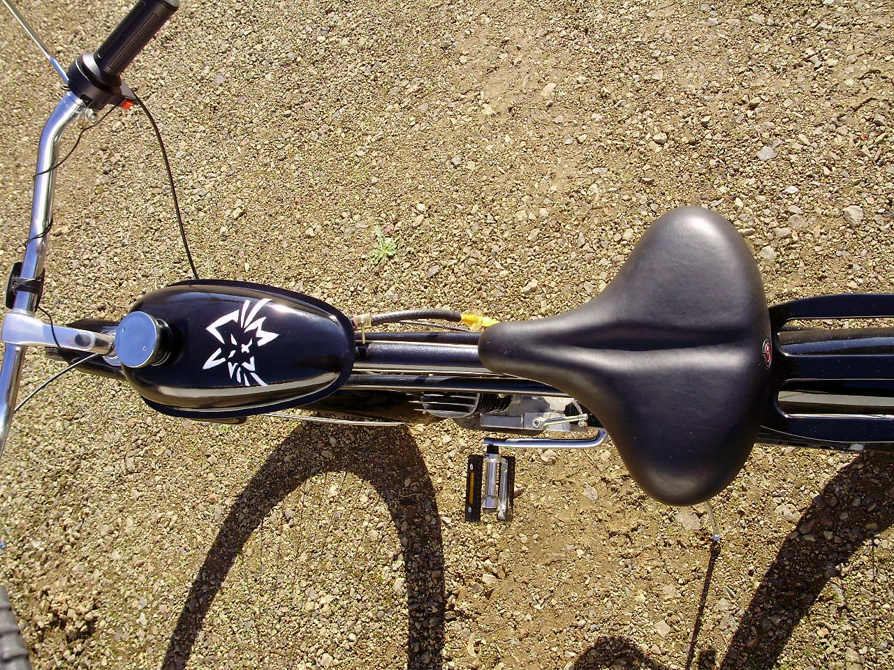

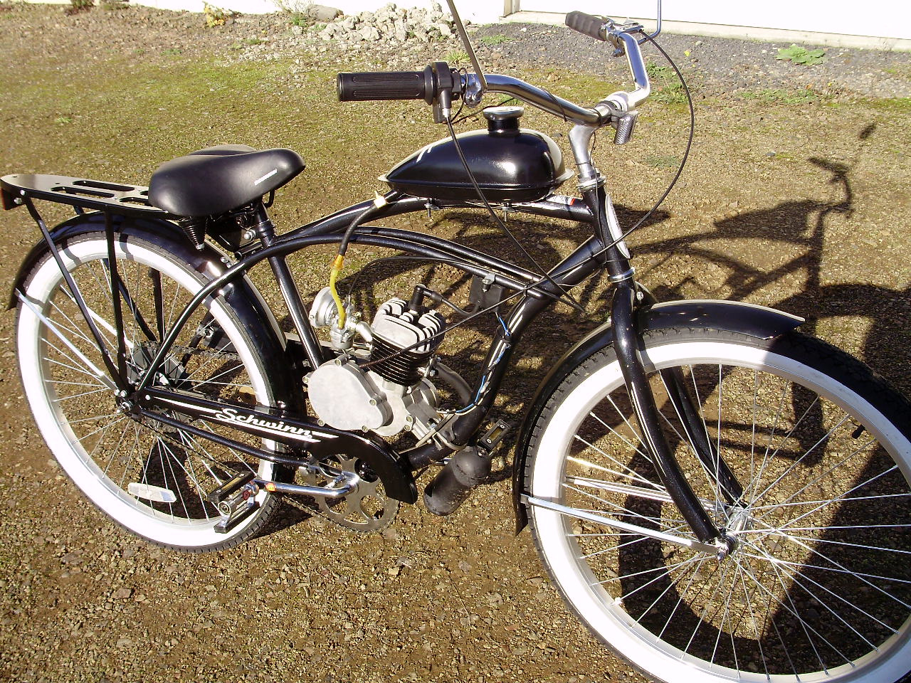

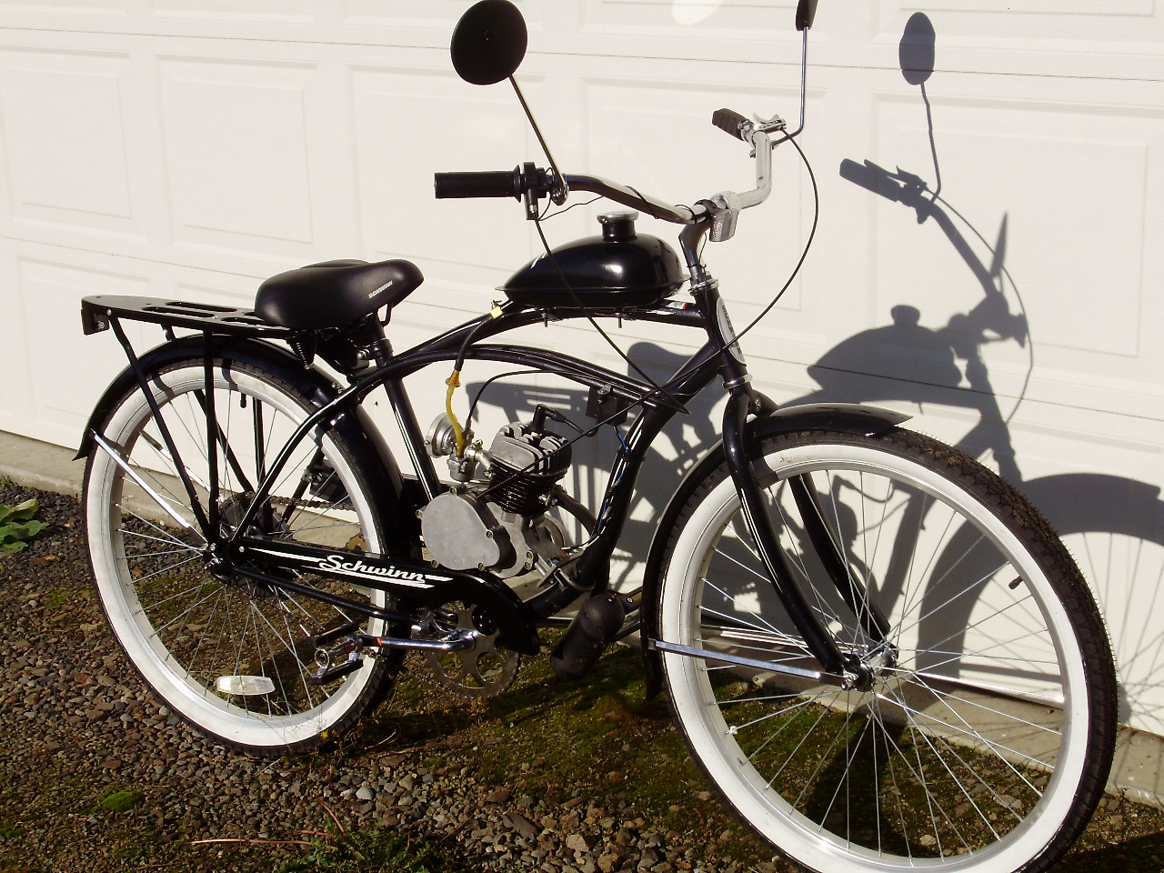

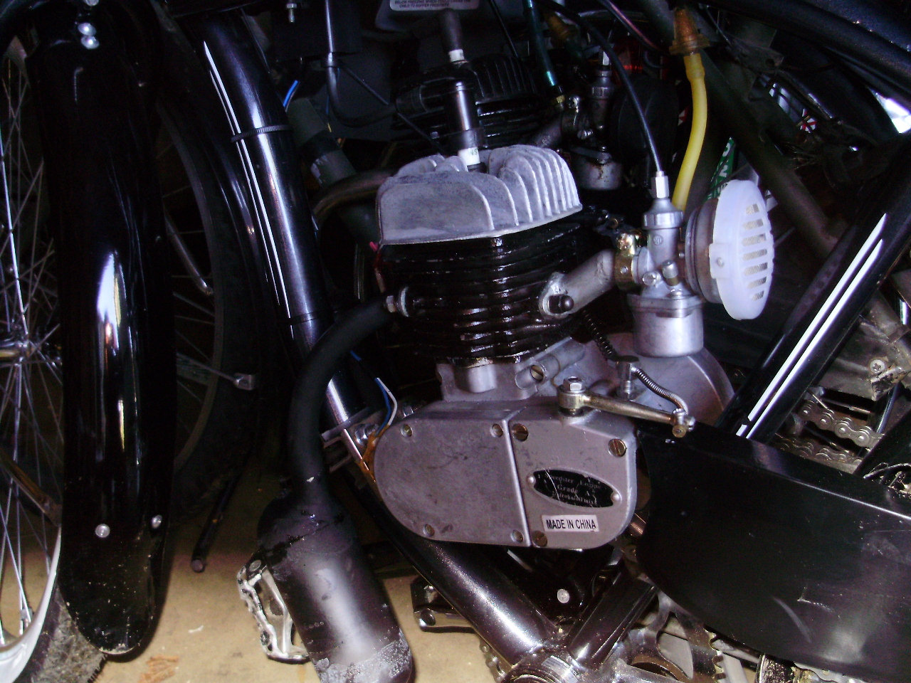

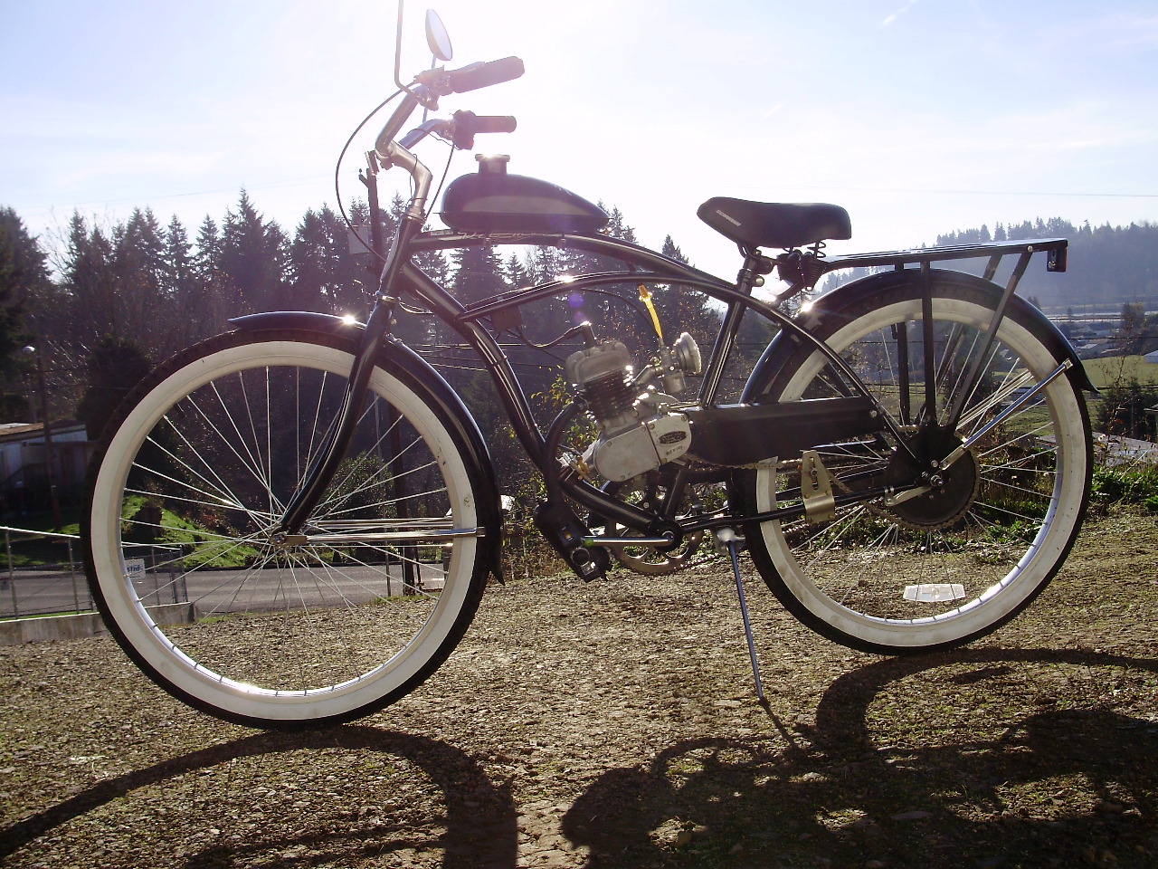

This has the 60CC Black Tagged Speedster Livefast Engine kit.
I Upgraded the Delmars Fender rivets drilled out to 10/32 Machine screws with washers on both sides. Black Phosphated Sprocket and Grade 8 and 5 on some hardware and all 1/4" studs B7 grd. Did the Special Bend for the Expansion chamber. Painted my Emblem for this Build on it the 'Black Cat'
I lace front rims to Sturmey Archer Drum with dynamo with 12 guage spokes and special order the rear wheel already laced 12 ga with HiStop Rear end..The biggest I've found., also will be using the same springer as the Cranbrook I have Posted here, Ill be Using the Tiger 70 and NTJL Silver Eagle 70cc'ers on them too (LiveFastand Nantong Jiali ). 'The Black Cat'.
Boy this 60 has pl..eenty of power. Power starts are a luxery and all of my CJR Engines have. I really enjoyed this build. It handles the best out of all the bikes I've used. The tires are 2.125" Thorn proof in rear wow I could put a passenger seat on one. HDPT

I like the look of the fenders & the rack. The front engine mount looks real solid!
Now you need a big headlight... Good job.

Where'd you get those mirrors? I keep finding only stuff that goes on the end of the bar
Old 12-07-2008, 01:07 PM
Hot Dog Piggy Tails's Avatar
Hot Dog Piggy Tails Hot Dog Piggy Tails is offline
Location: Kelso Wa
Posts: 76
Default Re: Blackie the 60cc DelMar by Schwinn and Speedster
our local motorcycle shop has them man are they sturdy. Honda Spree Aftermarket Mirrors 7/8's. OhThey include the little 7/8" clamp.
Under 8 a peice.
Thanks again Im thinking safety within what Im willing to put into these and Im thinking the Train headlight Venice Boy suggested is what Im going to do instead of the Springer..Oh and I also am upgrading the xfd toxfdd on the Hubs so Ill have to find 3 watt Headlamps I run the rear .85 watters off of these Magnetoes and they are bright and dont effect the spark gotta use 20 volters though like the ones in the Schwinn Approvedd dynamo sets (Chrome)
