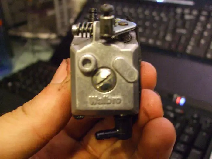

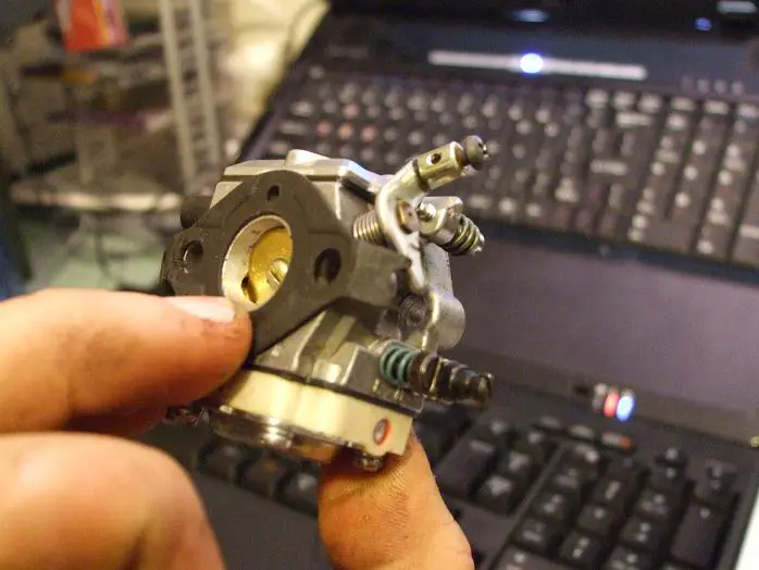

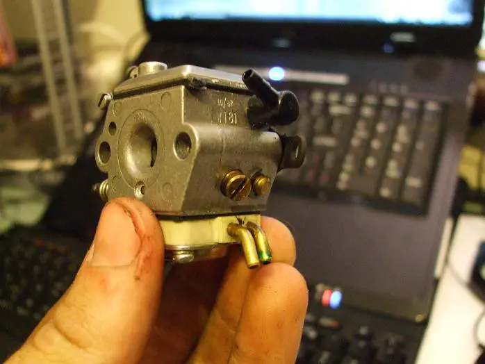

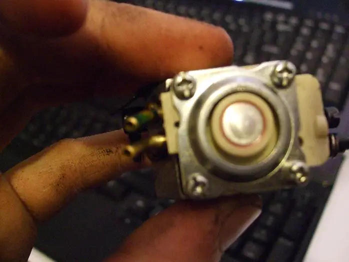

And whilst im here, i have a walbro WT81 carbie from a WW that has 3 nipples, a sealed up primer bulb hole and looks brand new. There is some old rubber from a fuel line stuck on one nipple on the primer side and the other is clean, there is also a black nipple on the other side which is larger.
My question to you is, what goes where? ive only dealt with carbies that have 2 nipples.

3 nipples?
1 nipple goes to the fuel tank to get fuel.
1 nipple goes to the fuel tank to return fuel.
1 nipple goes to the intake to suck fuel fumes.
I have the same carburetor, and the shop just finished my modified intake manifold to accomodate this 3rd nipple. I might finish my installation over the weekend.

Try this: http://wind-drifter.com/technical/Wa...viceManual.pdf
I think you can find your answers on page 26 and 28.
1 nipple sucks fuel from the tank.
1 nipple removes the air from the fuel line and returns the fuel to the fuel tank.
1 nipple is for the impulse to pump fuel.
If you need further clarifications, just reply to this thread. I'll try to get some pictures to show which nipple goes to where.
