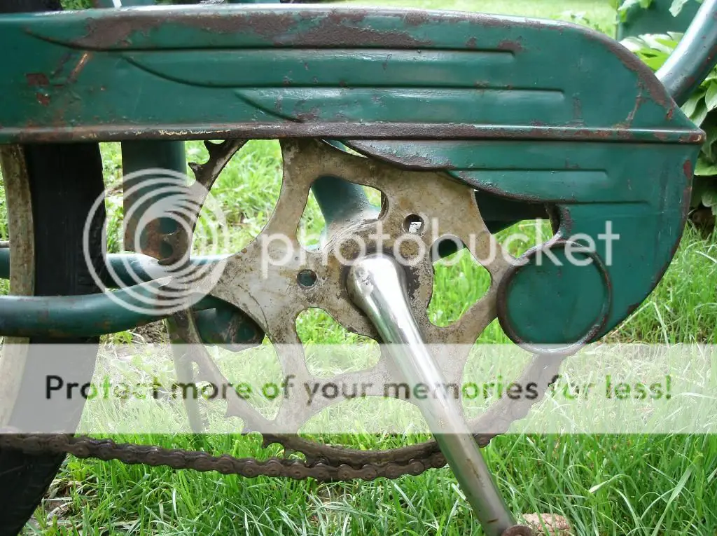

Ok so I don't know a lot about vintage bikes but I picked up a bicycle at a local fleamarket for a price I just couldn't refuse. I have been trying to research the bike since my first job is restoration. Everything is coming apart. Bearings replaced. Any non conforming parts being replaced. She needs new pedals and I think the crank sprocket is the wrong size. All in all she's in very decent shape. So first things first. I want to positively id the exact model. I am fairly certain she's a 1951 Schwinn by looking up the serial number and I think a Panther the problem is the Hornet seems to look the same. How do I know the difference? I also have another little issue. The lock that is on the front forks. What exactly does that do? How does it work? There is a key broken in it and it's not seized in there but I can't seem to find anything small enough to pull it out yet. Is that going to cause me a problem? Also there is a number on that lock. Can I get a new key made from that number? Too many questions. Sorry.

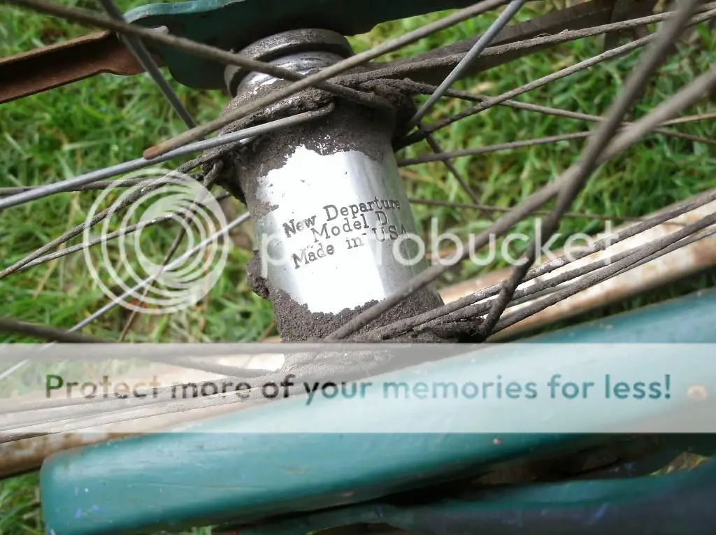

sounds like you found a really nice bike i would reconsider motorizing it the sprocket that you say is wrong size is prolly a skip tooth sprocket with matching rear wheel coasterbrake that says new departure with a oilcup on the hub is this what you have..if it is leave it original

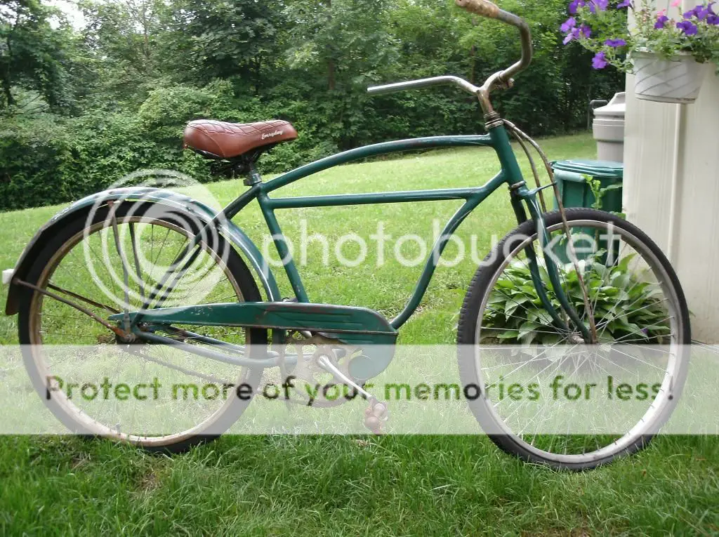

The serial numbers will tell you the year month and day it was stamped, but not the model. If it is 1951 then the question is what frame design does it have... is it the straight bar (commonly referred to as the Panther or does it have a cantilever frame in which case it is not a panther. Both frame types had different models distinguished by color and paint design, decals, more or less expensive shiny do dahs (lights, fender ornaments, etc.).

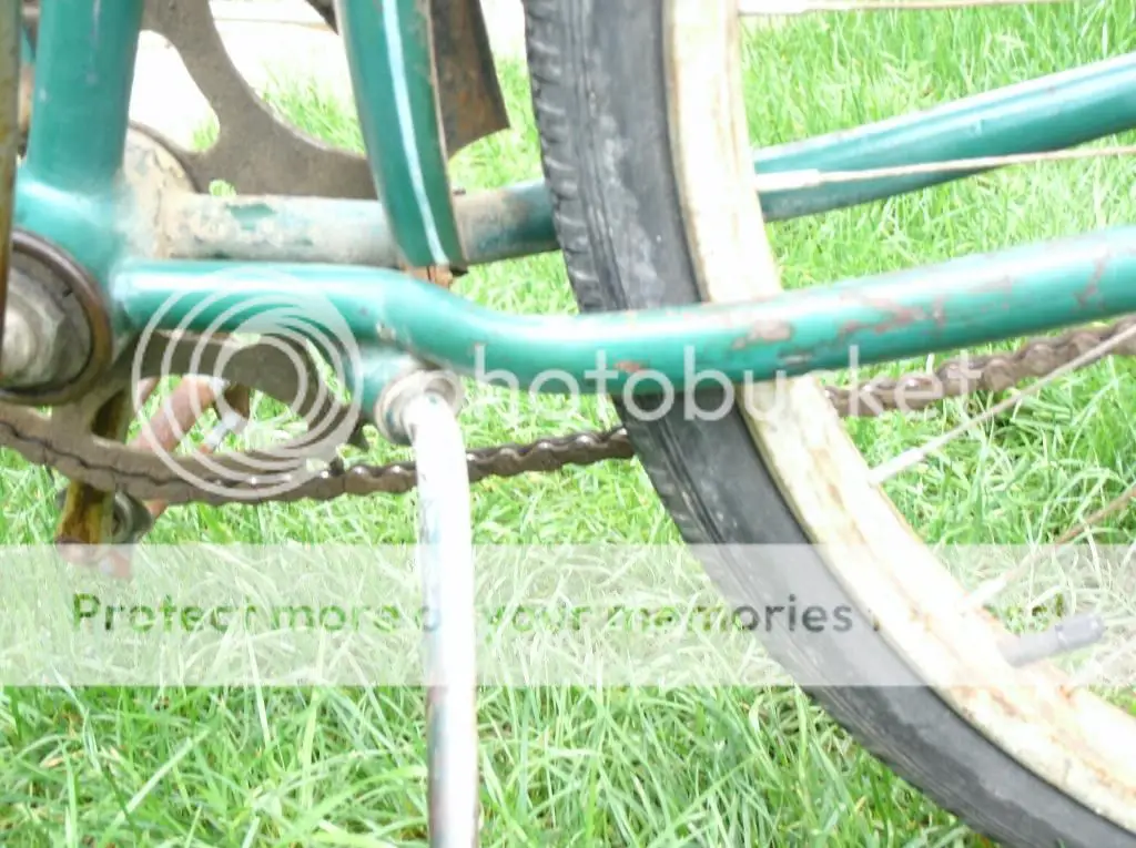

I will post pics as soon as I am able. The reason I think the sprocket is wrong is because it is actually worn a small spot into the frame from being pedalled. I figured it must be that or maybe the bearings need to be replaced. I don't know anything about skiptooths other than the pics I'ved seen so you guys would be better at telling me that. The thing that confused me most were the forks. The forks are different than the 51 and I've since found a pre-war Schwinn with the same forks so maybe I'm off base. Maybe it's older. I would love to convert it but if I shouldn't I'm down with that too. This is exciting!

My first panther had a worn spot from the cranks being loose. If it has a straight bar right below the top curved bar and a kickstand behind the seat post tube it is most likely a panther with a skip tooth set up.
