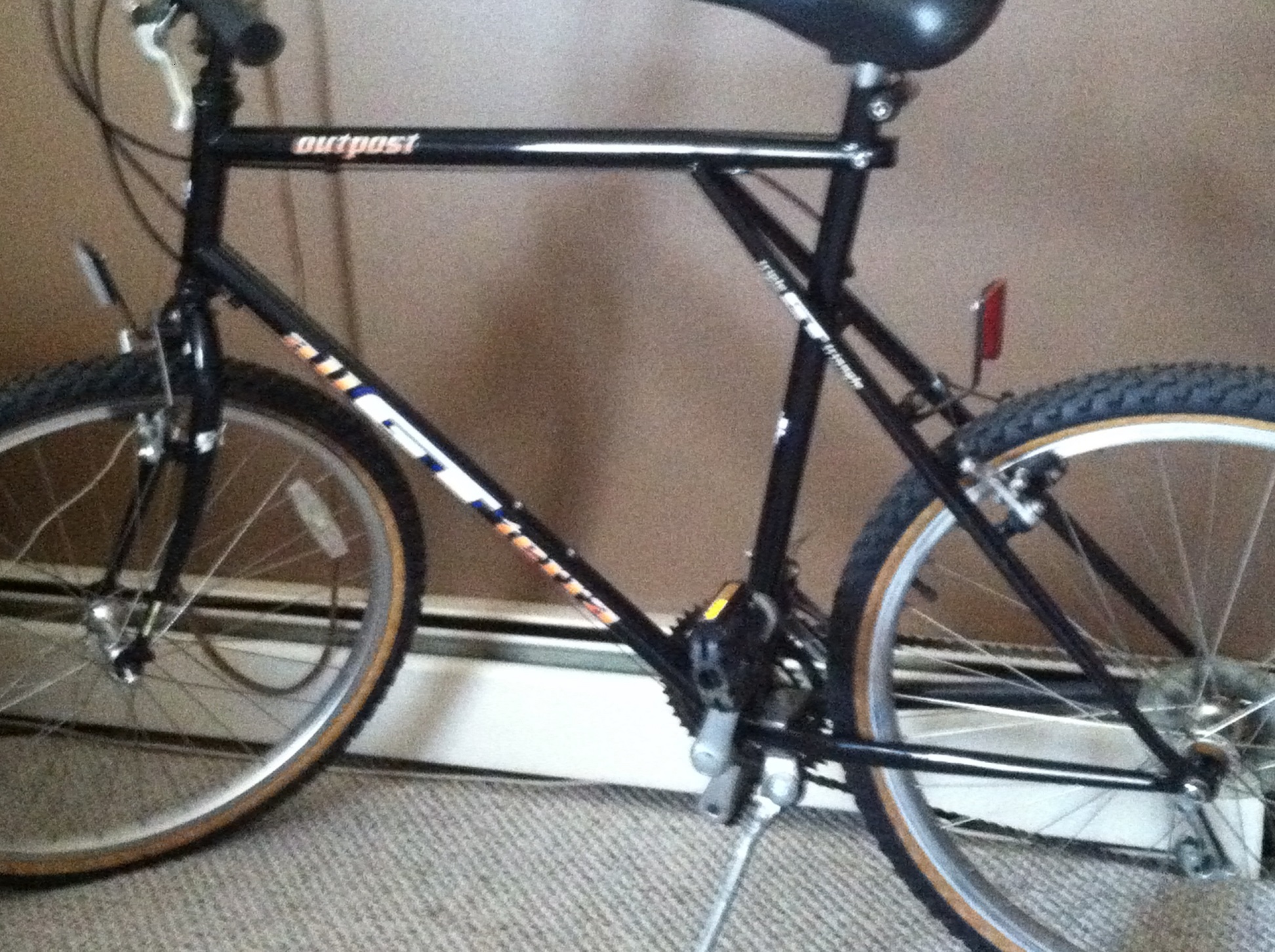

im gona throw it on my mountain bike ,it kinda looks like the bike dax used for his demo install of the 4 stroke ,so I should be ok ,no shocks tho ,oh boy !
keep us posted on what you come up with !
