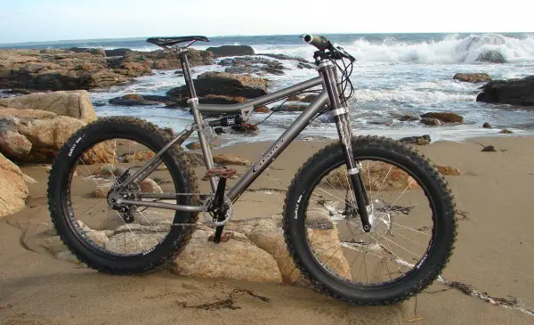

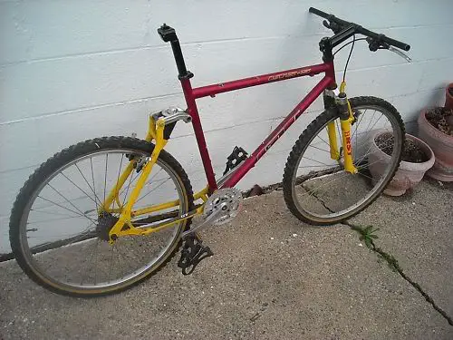

Here are some examples of what i mean (NOT MY PICTURES)
But this one is the most fulls my design needs
i would just change the fork tube for an over and put a disc brake bracket, but the location of the rear shox is THE one i want.
i just love motorized bicycle better than motorcycles, i mean, motorized bikes have that more ''freedom'' and fun sensation than motorbikes.
What u guys think of the frame build? i will proceed to do the blueprints and show it to a blacksmith (meanwhile i get a welder)

Cool. The Specialized GTS would be my first choice for a motorized rear suspension mountain bike. Plenty of room for a motor in the front triangle and the four link rear suspension limits chain problems.
