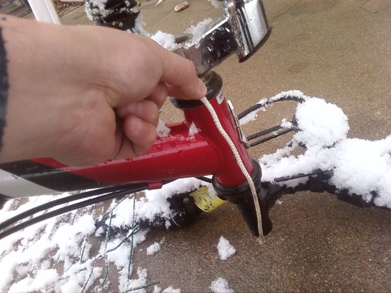

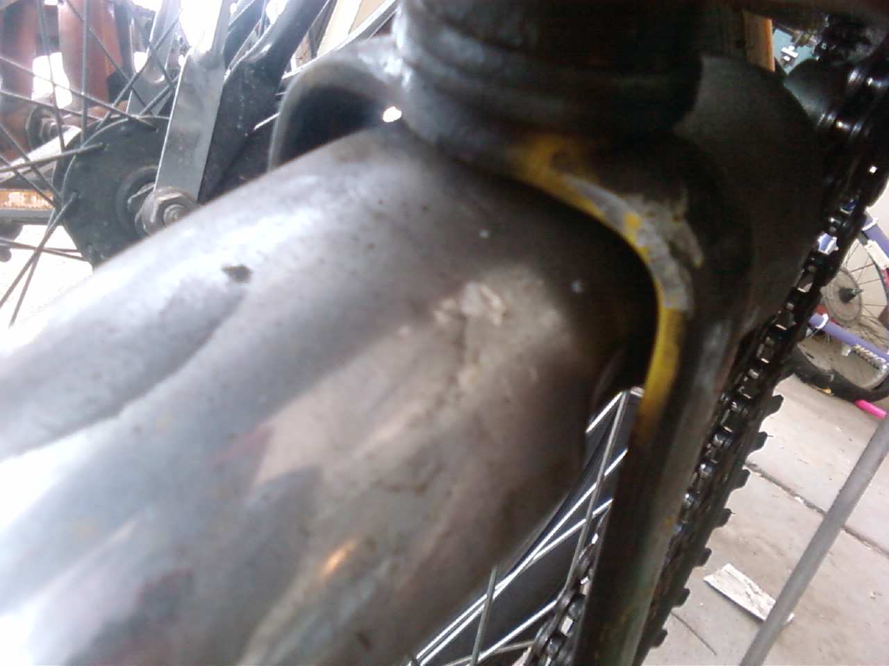

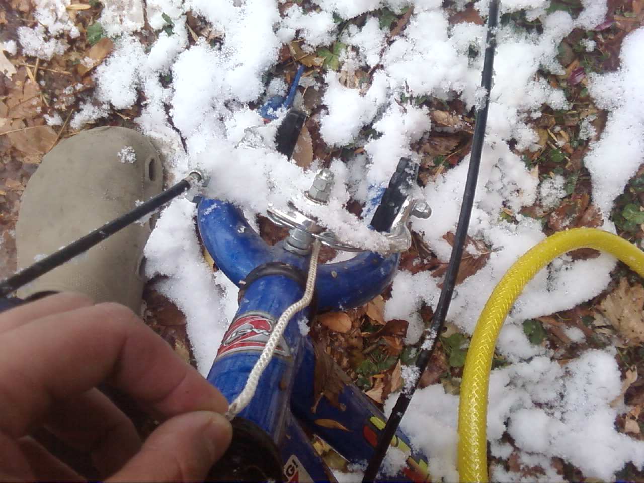

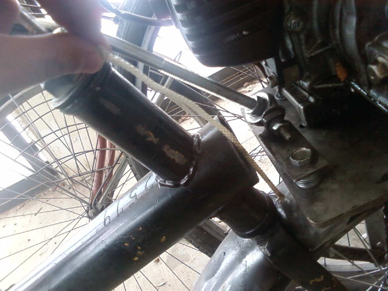

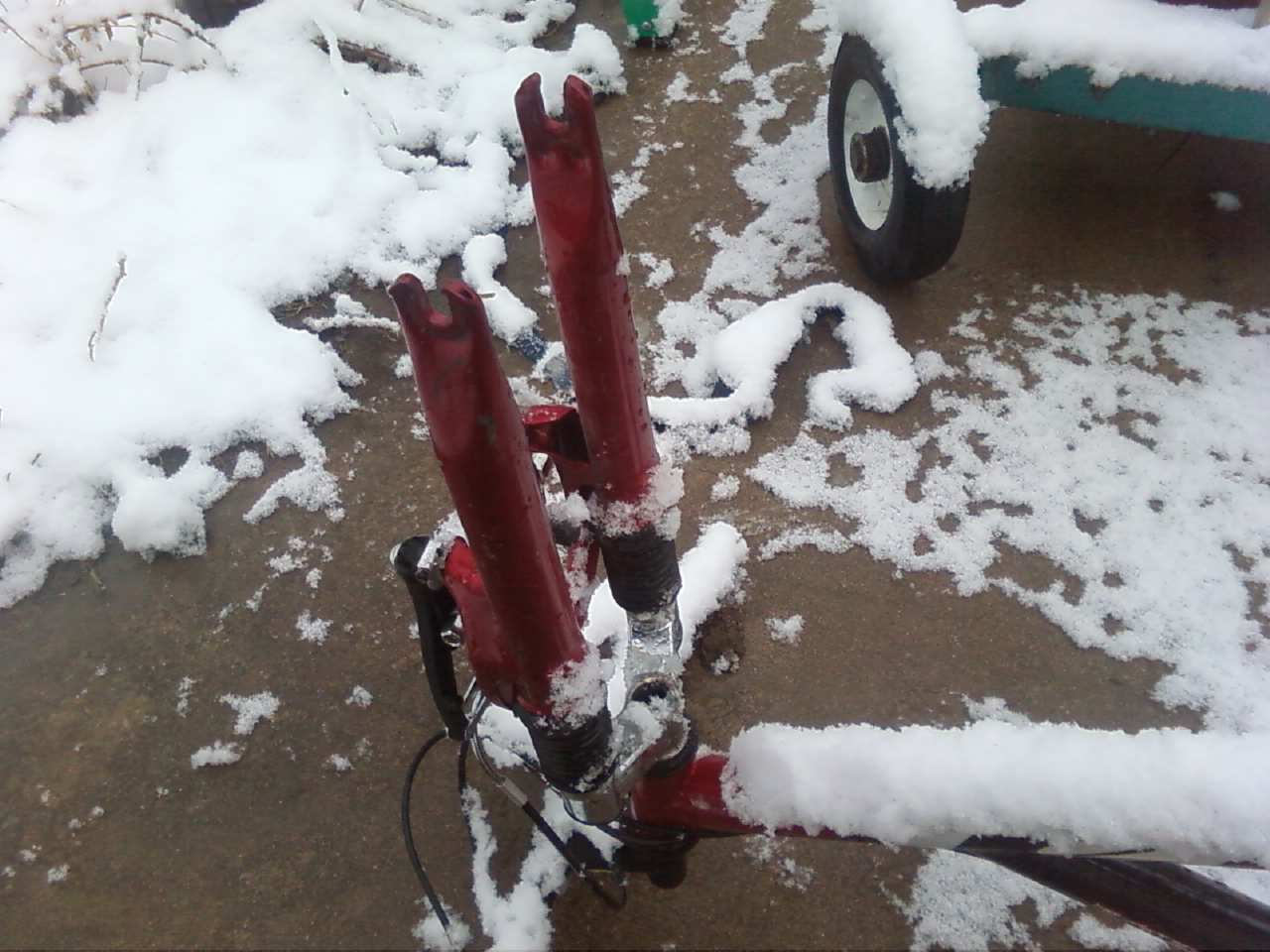

I need a little meeting of the minds here. Look at the pics below for reference.
I have just a coaster brake on my Trike and the other day my chain derailed and suddenly I had no brakes whatsoever.
So up front is my Worksman fork designed for my drum brake wheel and no provision for a caliper or V brake whatsoever.
So replace that fork? Sure except that Worksman fork stem is way too long. I couldn't find my ruler so I used a string but you can obviously see how much longer that worksman fork is.
I also though that maybe I can simply cut the frame tube down to accept another fork but there's a reason for the long length and I don't want to compromise this frames integrity so unless I find a fork with a long stem this fork stays.
And the drum brake wheel sure I can simply install that back on,lace up the sprocket and call it a day but that sprocket isn't 100% true,and it's coming off the hub.
I'm about to get my 3 speed on there and although it's a coaster there's no way I can get it to work up front. I did look at that one mod someone did to a swing bike converting a coaster to a cable brake but I know these 3 speeds are complicated in there and I don't even want to deal with it so that's out.
I also thought maybe I can have someone weld me some bolt stays for a V brake up front but these forks are rather thin as it is.
Then I thought maybe a cable brake for the rear axle. At least if my chain ever derails again I still have that.
There has to be a rather inexpensive fix for this. How do lawn tractors slow down besides engine braking? How about go carts? Is there a way I can install cable brakes on my rear wheels?
(The rear wheels have no frame going around them)

V-brake studs are usually brazed on which will not hurt the fork legs a bit. You can get a couple of braze-ons at a bike shop a $ or two apiece.
Another option would be a heavy L bracket between the fender and fork steerer for caliper brakes. That would drop your fender the thickness of the L bracket, though.
Hmmm . . . maybe a band around the bottom of the steerer/top of the fork arms with a stud for calipers? Have to be long reach for fat fendered tires but should work. Like a heavy duty hose clamp with a stud sticking out. As far down on the steerer tube as you can get. Sheldon Brown may have written something on this.
Lawn tractors usually use a disk brake on the transaxle. Very crude and unreliable at best.
Disk brake hubs at front or rear would still require welded or brazed on mounts and re-lacing the wheels.
Can't you just find a brick wall to stop? What? . . .oh . . . you don't always stop in the same place. Gotcha.

I'm digging that L bracket idea. It would be nice if I can keep that fork because I like the fender.
The other forum has a solution to with extending the replacement fork with the v brake and suspension by welding on an extension from a salvage fork but I may not be able to keep that fender.
Your idea for an L bracket is quite simple.
I need to get out there and see how that fender is attached.
