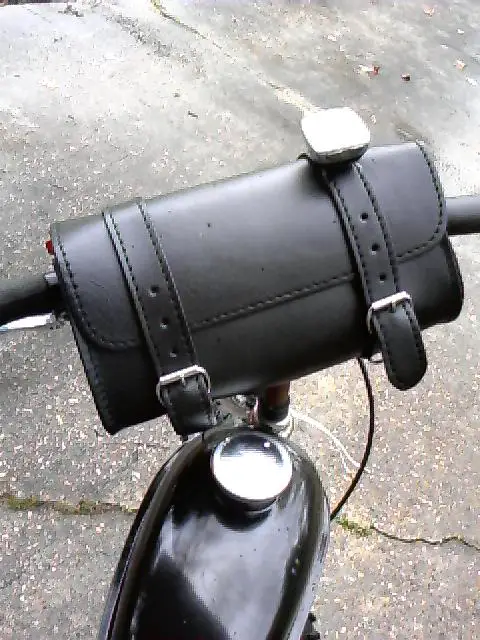

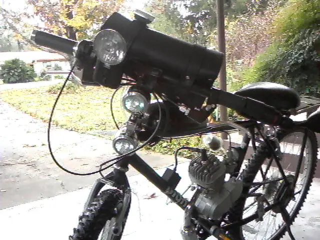

It is a powerkingshop kit. I used the kit as is... I was semi-retired 6 weeks ago and was on a limited budget. It has performed fine with the stock nuts and bolts with a little red and blue locktite and constant vigilance. Added a fuel filter, Wal-mart foglights run of and SLA 12 volt battery held in a Bell Leather handlebar bag... also from Walmart. And a flashy blinky LED taillight, not sure where i picked it up from.

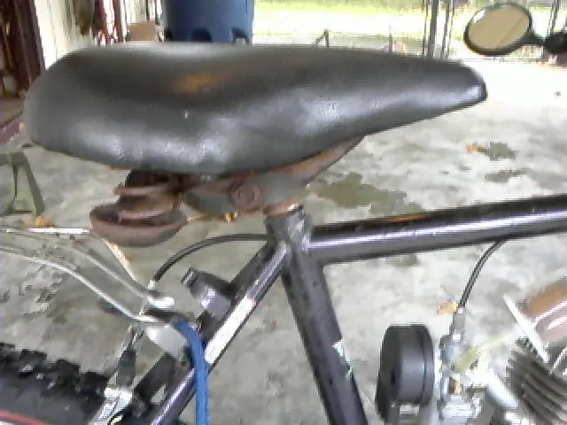

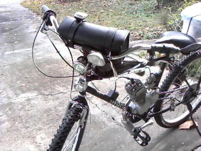

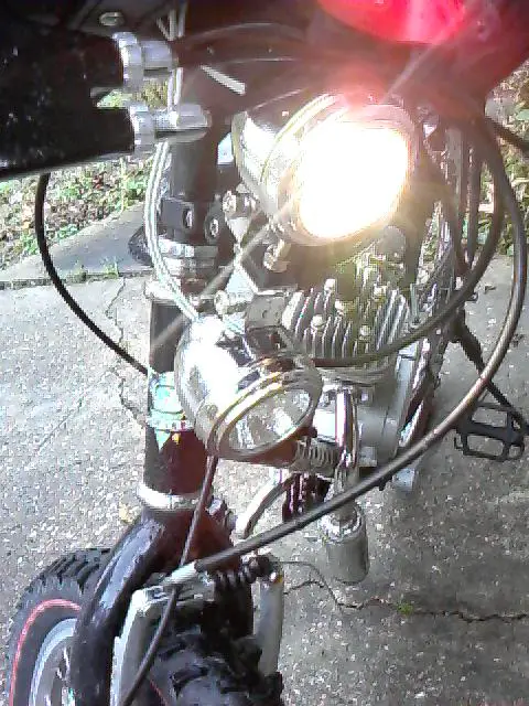

Thanks for the tips... I have liquid wrenched and used penetrating oil over 2 weeks. I have put the seatpost in a bench vise and twisted on the frame... no go. This frame was out in the weather for 10 years, i don't think i mentioned that. So I cut the seat post and tried the hacksaw in the post as Sheldon and wheelbender suggested. There was 8" left in the seat tube. It was so corroded that when i rolled the aluminum post with vise grips, the seat tube deformed; it was as good as welded to the post. Soooo, judicious use of a hacksaw below the damage and a steel 3/4 inch post was tapped into the remaining aluminum. I topped it of with a 70's vintage cruiser seat with springs. Now, I can put my feet down when i roll to a stop. It is a little awkward pedaling (little leg extension), so to start I just come off the saddle.
Pics are before the postectomy.

Default re: First Motorized Build

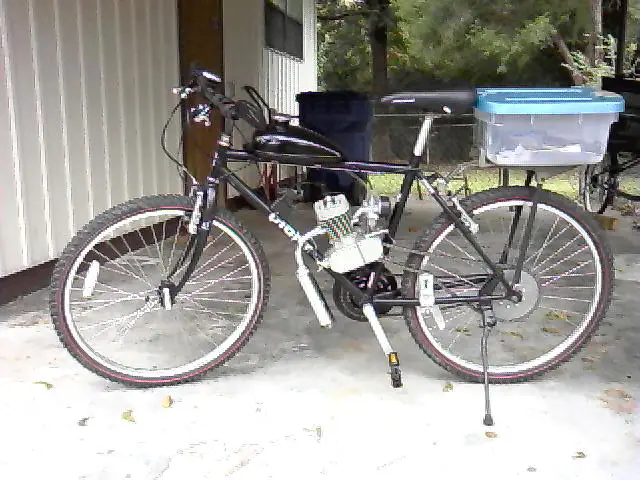

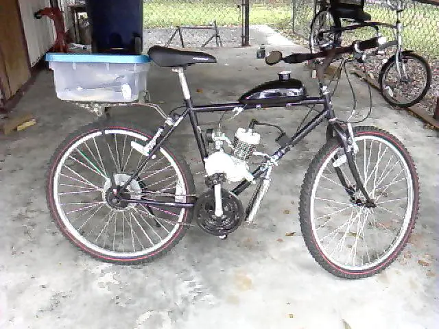

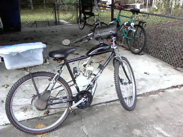

Here are current pics of my ride. First is how it started. Second is the seatpost alteration and new seat. Third, the straight bars and fourth, the huffy handle bars. The fifth is as it sits now, with my mountain bike and recumbent in the background. With the lower seat position and swept back bars, the bike handles completely differently. There is no pressure on my hands (all the weight is on my butt), and lowering my weight 5-6 inches makes the handling SWEET.
