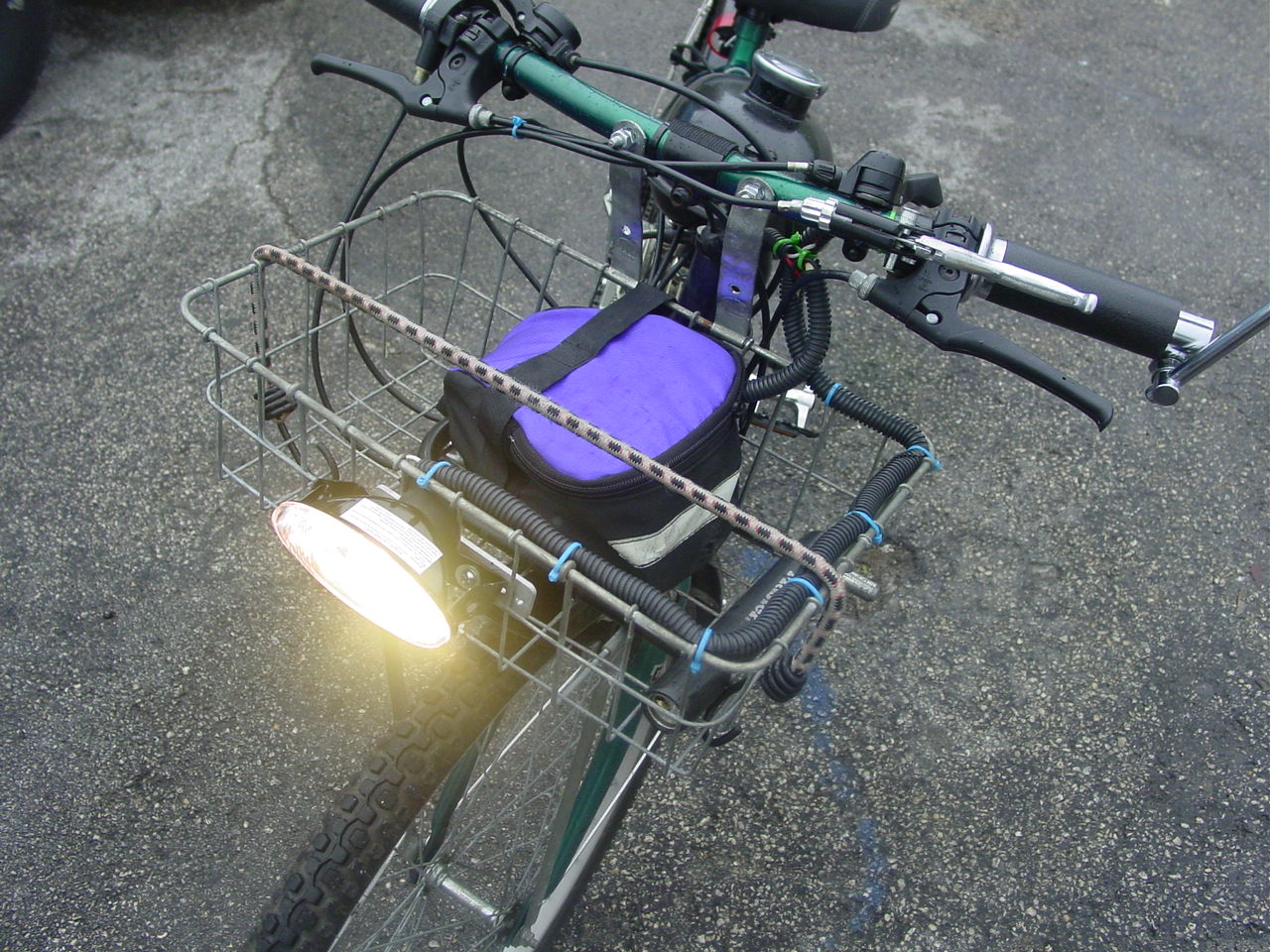

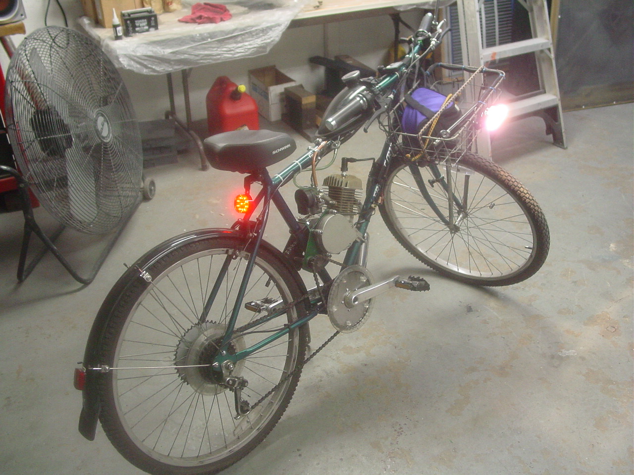

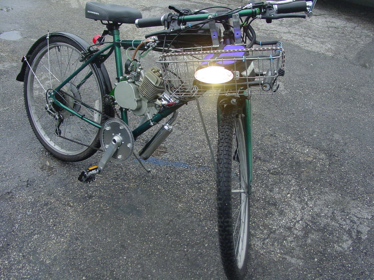

I used a 12v fog lamp from Harbor Freight (about $15 for 2) a $5 led tailight and a $30 scooter from batteries plus (very small, just carry in small bag in basket). It works good, but I'm going to use a xenon slim kit like on my motorcycle, $78 for 2 kits. The bulb will fit in the fog lamp and only use 35 watts rather than 55.
I charge the batt with a battery tender.
