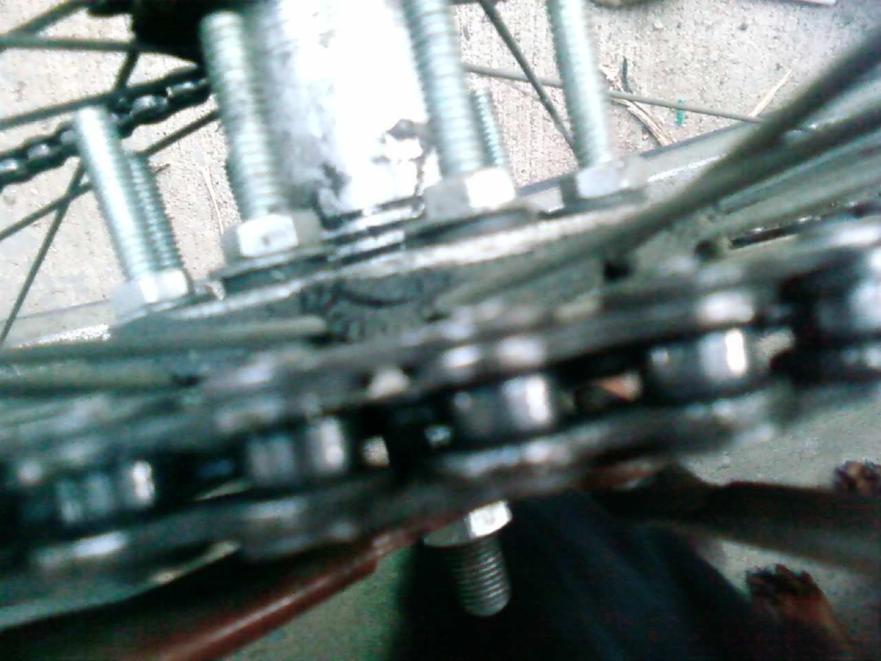

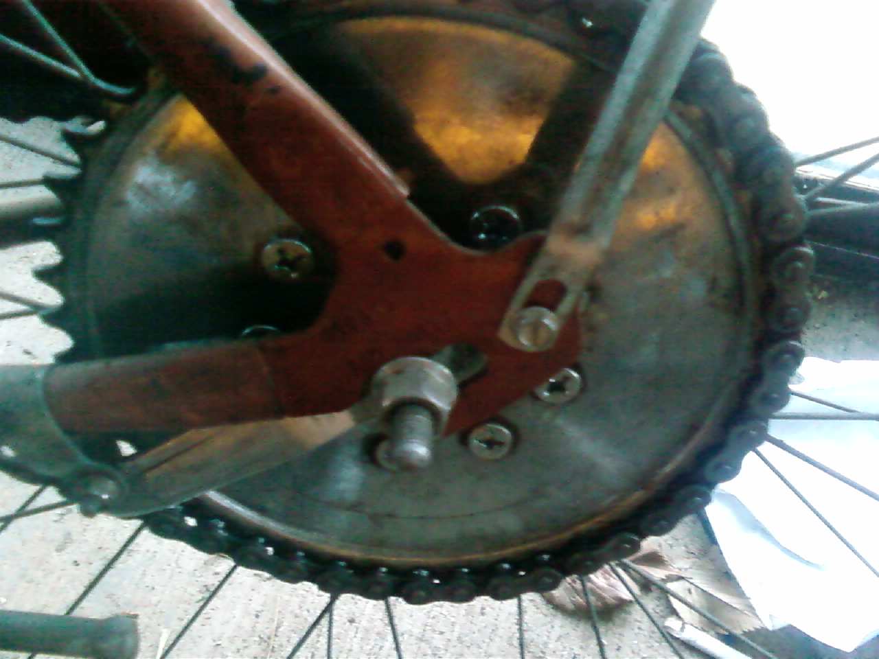

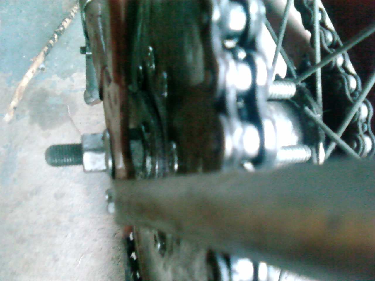

There's one nut in front of the arm. You can use your bike to keep the coaster arm in place while you loosen up that nut with a wrench. Loosen the nut that holds the wheel on the frame first. Or you can get a buddy to hold that coaster arm while you loosen the nut.
Then the bolts may get in the way of the coaster arm when you spin the wheel. People have welded up an adapter to clear the bolts. Others have given that coaster arm a good bend at the bench vise. I simply replaced my hardware with 1/4 flathead bolts. See the pics.
And no. They haven't loosened up.
And yes. It holds it good. Yes 1/4 is mighty thin but it holds up.

I didn't have any of these issues with my coaster brake. My coaster arm came off fine without removing axle or anything...there was just a square hole in the arm that fit around a square nut on the axle. Also, the bolts that came with my sprocket kit were hex heads that cleared it no problem.

On Cronus when I was using a coaster it needed some bending. It all depends on that coaster arm I would imagine.
