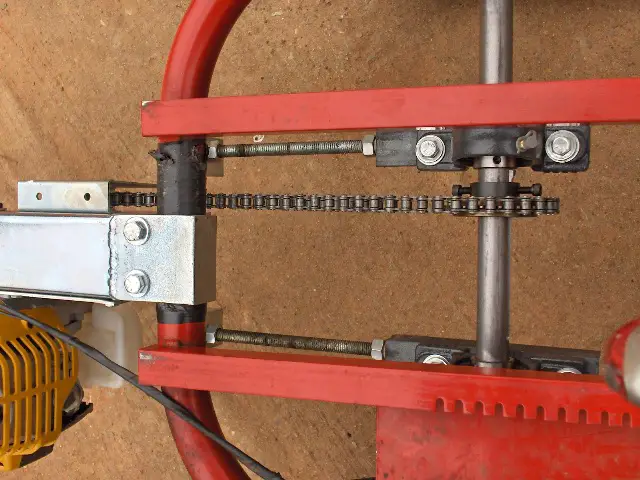

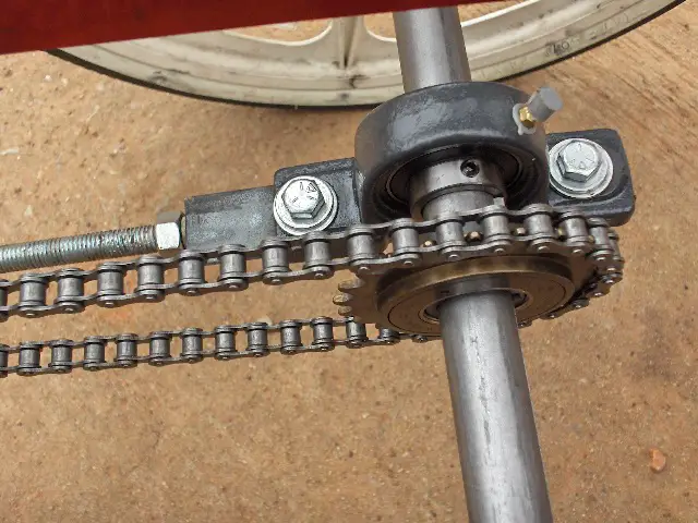

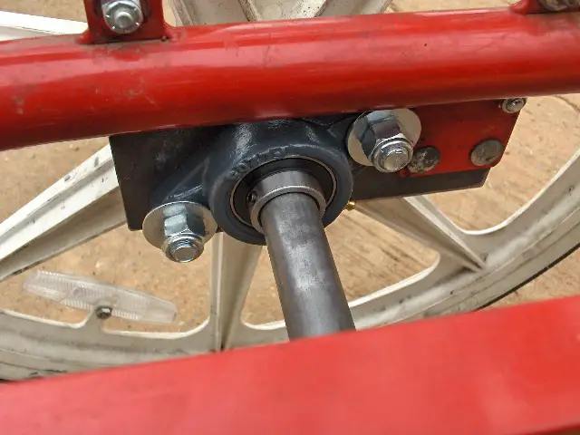

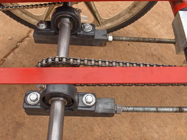

Anyone Who Has Done A Trike Can You Help Me Out? I Need Some Ideas On How To Mount Sprocket To Rear Axle Of Trike Kit. Trike Rearend Is From Us Cycles. Any Help Would Greatly Be Appreciated
Oscar,
Don't know if these will help or not. This is an install on a weird little trike but the rear axle and sprockets should be about the same for all of them.
Good luck and keep us informed because I have a trike too that's begging for an engine.
