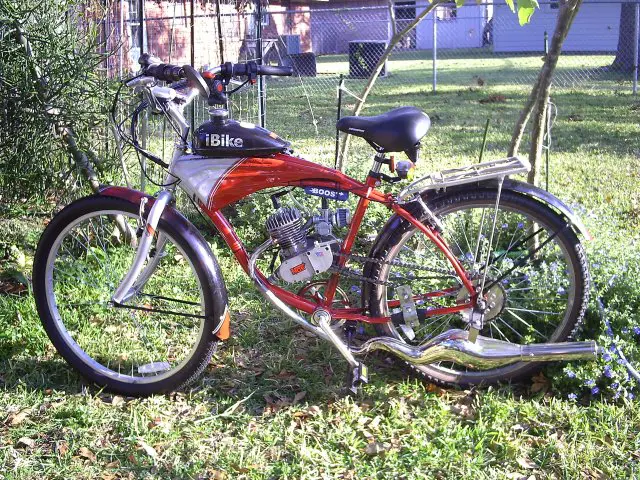

Hi and welcome to the forum. There are a lot of point beach builds here. I Got one for my son that another member built. You will need to shim the rear sprocket out to clear the rear tire. I used 5 washers per bolt behind the sprocket. The engine can be mounted lower if you do away with the front derailer. I mounted my motor much lower then my son's "i bike" Good luck and there is lots of help here if you get stuck.
