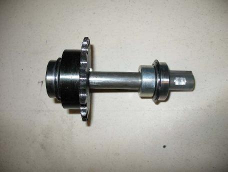

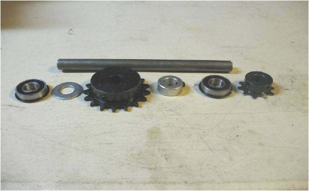

Originally Posted by hiker472 View Post
Uhh.....excuse my ingnorance, but what is a "jackshaft?"
I checked out that site and like the price on it and I think this is a great idea.
see pics for reference on jackshaft... It is a great idea. However, it would require you to have a 125mm or longer bottom brackets, or else you won't be able to get the correct chain alignment.
