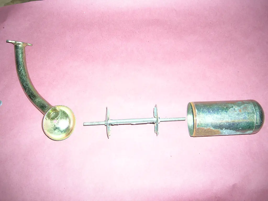

I started out with the Livefast 55cc econokit muffler with a tack-y welded baffle made of very very thin galvanized sheet. (photo 1)

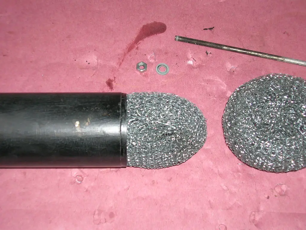

I deleted the stock baffle and replaced it with a "Chore Boy" type steel mesh scouring pad, inserted into the muffler can length-wise. (photo 2) One will do, I got a pack of three for 1.68.

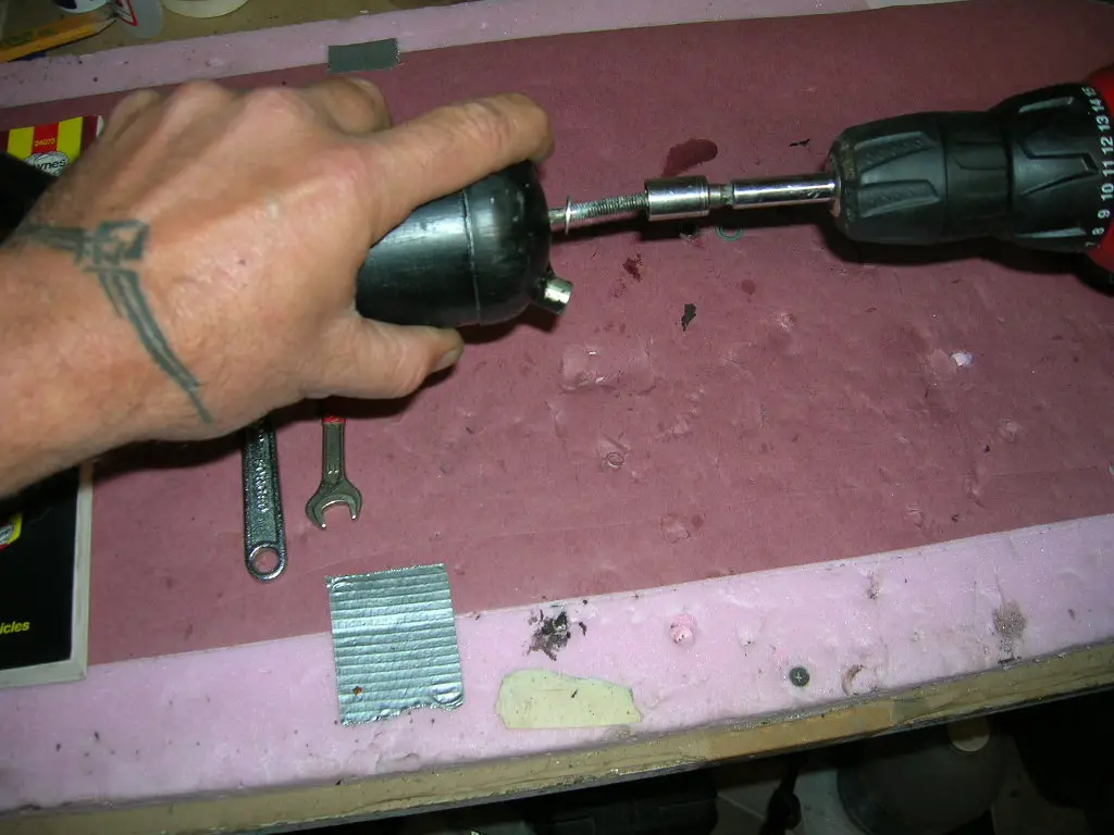

I used the old cordless and a 10mm socket to run the threaded rod down through the "packing" (photo 3) and then loctited the whole works together.
