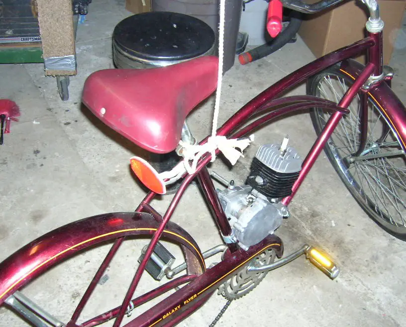

I guess I'll "blag" this one....
The bike is a Western Auto Stores Western Flyer, but it is a "Galaxy Flyer" variant. It has a 72 as the last two serial numbers, and the hub says Bendix 76, so I am guessing it id from the 70's...sure look it. Dark burgundy with orange stripes/"graphics".
It has the abreviated fenders and old school "regular bars", burgundy grips/seat.
I have built two other Western Flyers, and this one is different in that it has a larger elongated frame compared to the other two.
Lots of space for the 47cc bicycle motor kit.
The engine is a 55cc Livefast economotor kit (around a hundred twenty bucks shipped) that checked out to be 47cc's. The funky 5 hole 48T sprocket was replaced with a rough stamped 44T/10mm hardware 9 hole from a thatsdax kit.
Other than new studs, a good clean up, and a greasing of the gears, the engine was left stock right down to the plug and wire.....using this bike as a "mule". I did "true up" the sprocket with a rubber mallet.
Photo 1 shows the custom bike stand I use.

nice bike joe. Did your engine fit without the over sized front fork adaptation?

Yep, dropped right in....almost. The "V" is actually pretty flat or "open" if you will. The engine touched the chain guard until I put the lead sheets in, which raised it just enough.
Tubing size is 1" both tubes.
I got the bike for 35 dollars this past summer @ the flea market. It has a different kind of rim, not sure what they are, but they are a deep v type, not like most I've seen.
