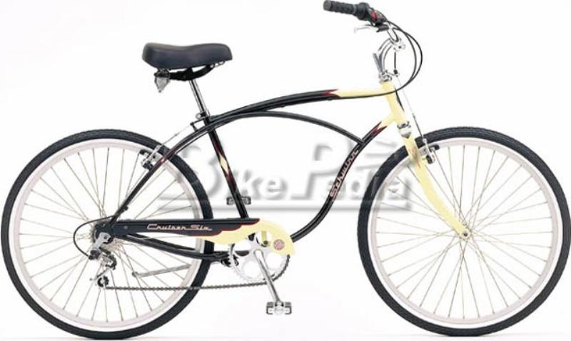

hello all, new to the site. just wondering if any one had experience with a cantilever schwinn? i ride a 1995-96 cruiser six anniversary issue schwinn. the rear brake yoke is in the way of mounting hole for the rear phantom rack. the adjustment of the yoke is`nt enough to get it up and out of the way. the cross cable will rub or grind away on the rack. because of the arch. should i check into disc brakes and what cheap disc brakes will work for my application? thanks for any help. wez.

go for disc brakes, if you have the budget. If not, try one of those drum brakes. Cantilevers are quite useless when it's wet. I'm converting to disc brakes, but still saving up the budget. My front is already disc, only the rear needs conversion.

thanks for the info. sending picture. the drum brake sounds like it might be a winner. checking online for drum brake parts. and cost? as you can see the yoke is right in the way of the rack mount hole. i can still bring the yoke up to just short of the cable holding bridge. if i were to use screw sleeve as a bushing,i still think it may be a future problem. thanks and i will check into the drum brake idea. all my best wez.

You can upgrade to V brakes using the same mounts and they are quite a bit stronger than canti's and stronger than the hub brakes too. Discs would be hard to retro on that frame. I have V's on my bike and they work quite well.

the problem is in the rack mount and the fenders. the v brake may work, but i need to get on the outside of the rack and fender. plus the brake cable bridge is in dead center. if i use the v brakes do they have a center pull? i think they only come in a left or right pull? wez
