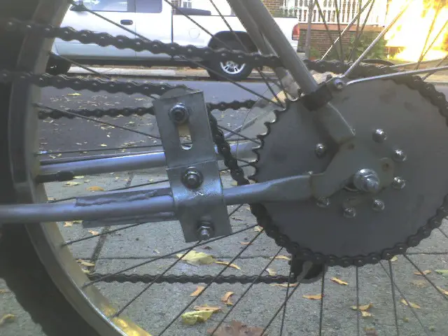

I took two 3/8in x 3in axle keys and welded them to my chain stay it works beautiful and allows you to adjust to the chain stretching.

Hi Hse, your bike will perform better if you remove some of the links in your engine chain, slide your tensioner forward and then re-adjust.
The ideal situation on a chain sprocket, is 50% of the teeth engaged with chain. When I look at your pic, you only have about 11 teeth not engaged.
Power is lost by all the extra chain contact, and the fact that you are letting the chain "climb" the rear sprocket.
Try it, and see if you can feel the difference?
BTW on frame drilling, I NEVER have drilled ANY bicycle frame, with the exception of drilling thru the crown on very old american bikes, to install front brakes.
