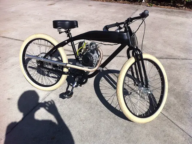

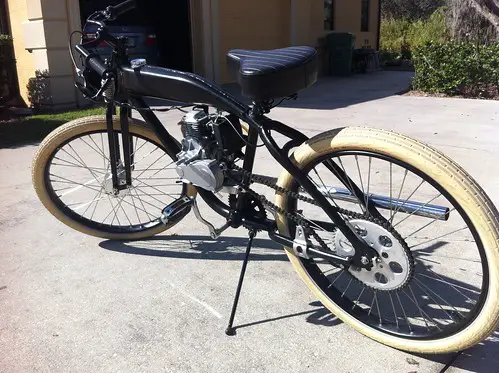

It's been almost a year in the making, but I finally finished my bike enough to go for a nice ride today. Still need to put on a bicycle chain on the pedal side and tune her up a bit, but this build is basically done. I short, here is what makes it up:
Felt Propaganda Frame - Tank sealed, KW Machineworks Billet gas cap and bung installed and powdercoated by Norm @ VMB
Felt Abraham Linkage fork
Worksman Wheels with drum brake and Schwalbe Fat Franks
Huasheng 142 49cc engine with that's Dax transmission
Pirate Cycles sprocket adaptor w/ 52 Tooth sprocket
KW Machineworks Chain Tensioner
Phantom Bikes Engine Mount
Phantom Bikes Exhaust
Domino Throttle and Clubman Handlebars from Treatland
Plus numerous other bits and bobs from numerous vendors.
More Pictures HERE
I'll post more details later when I have time...
