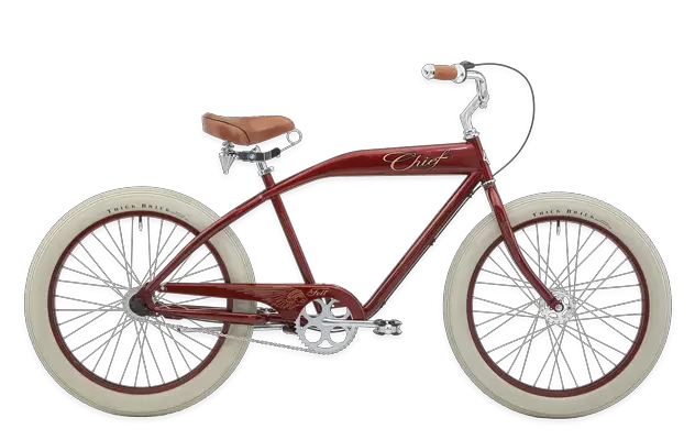

Capt, Imagine the chief here powered like that. (might need some break'n, updat'n)

That motor won't readilly fit in a bike frame it's a horizontal cyl that is too long. If you change the positioning you have to modify the oil syphon in the sump. most bikes that use this motor hang it from a top tube frame. It probably weighs 60-75lbs and has too much hp (i'm guessing at least 7 or 8 hp) for a bicycle.
