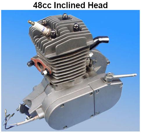

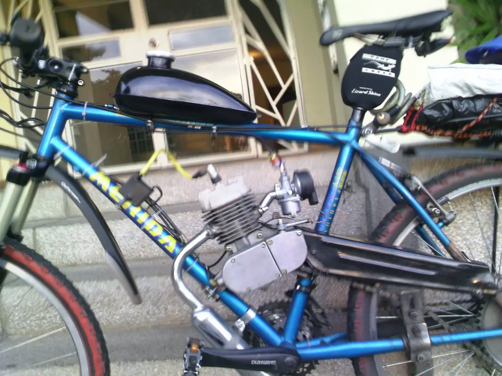

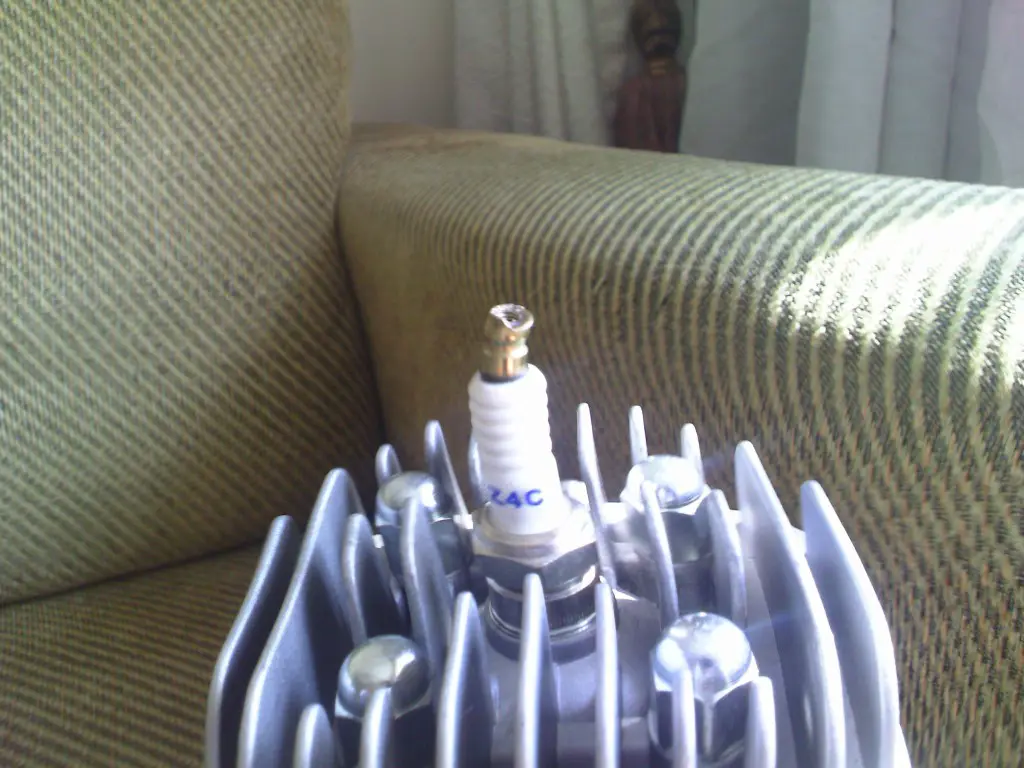

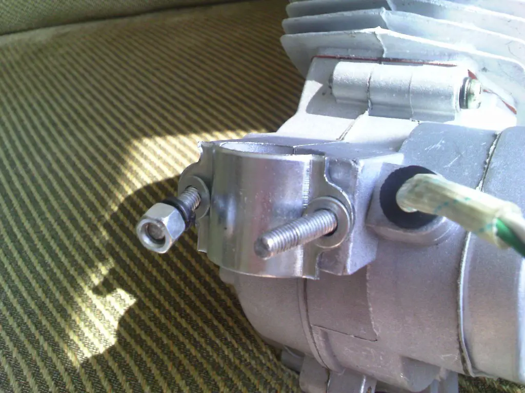

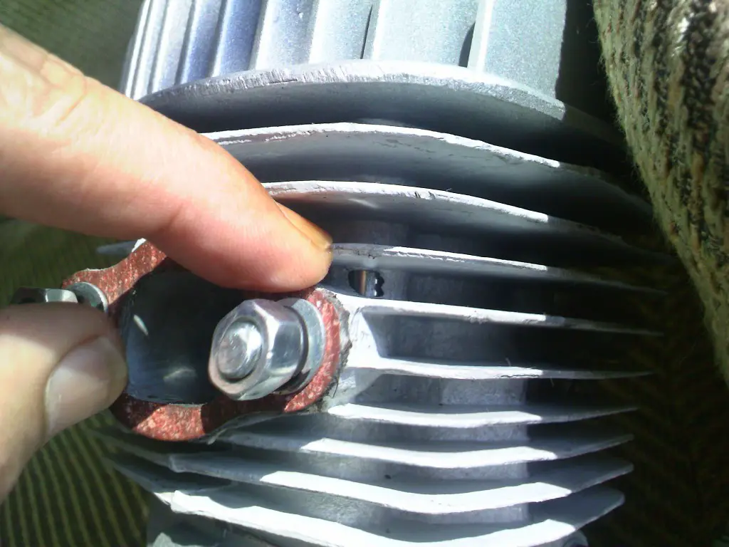

Yup, Warren is great guy. I got 2 of my Z80 engines from ZBOX. My first engine got burned... :-( It was probably the intake gasket leak that caused the engine to run too lean, and probably too much synthetic oil. Mineral oil is still best. My second engine got a gaping hole from a cast bubble found near the exhaust. The hole did not go through the cylinder, so I just cold weld it. Also the engine mounting bolts and the spark plug got bent during the transport. I just replaced the bolts with stainless ones, and bought a new spark plug. Try to get the angled head. I heard it's more durable than the standard ones. He does'nt have it on his website but you can ask him about it. But it's a little bit more expensive than the standard engine. Be gentle during break in period, which is about 5 full tanks. Remember to replace the intake gasket with a good one and try to cut it in shape so the gasket covers all the gap between the engine and the intake manifold. Also, a rubber O-ring would be good to seal the intake and the carburetor. I still plan to change to a pocket bike engine once I get the engine mounts work out, and the budget to get it... :-)
