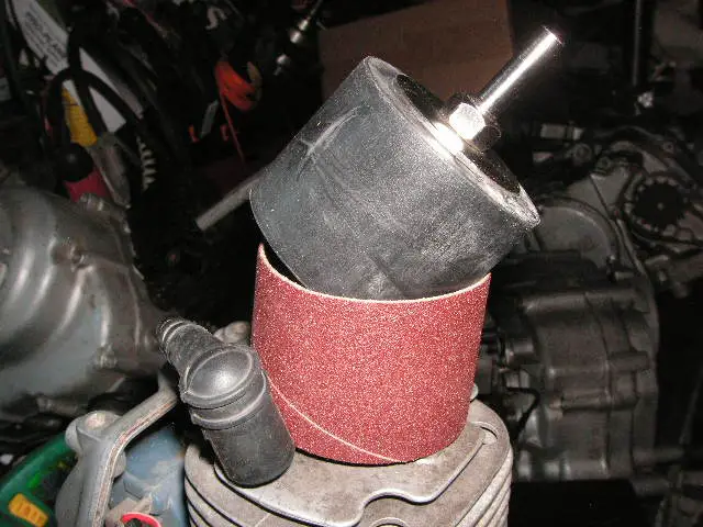

Deacon I came across an idea today. As I was out finding my way through the mess in the garage I came across the sanding drums for my drill. I got them from Harbor Freight tools for 7.95 for a complete kit. I was thinking that it would be easy to mount and you could change the friction material as it got messed up. I think you could get some from any tool store, the only thing mine are 2" in diameter. I think you could get less. Have fun, Dave

I was thinking about using the same thing with no sand paper. I would think rubber on rubber is as good as you could get on a friction drive.

You know you could weld those to the end of a 1/2 pipe nipple with the rod inside the nipple then just screw the nipple into the end cap that you had bolted onto the flywheel. It would be a fairly easy wheel to make, To be honest I had never seen one of those before. My drill mount sander is flat not round.
