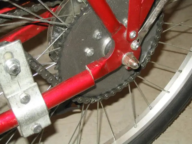

Last Sunday, at exactly 455 miles on the odometer, while riding locally with a friend on a similar bike, I turned onto another road, and felt the back end getting squirrelly - like the wheel was coming loose. I was able to pull over & discovered that the frame tube in front of the rear hub had cracked completely through. Upon futher examination, I discovered that other cracks had occurred, or were forming, all adjacent to welds. One completely through at one of the smaller upper tubes near the seat, one forming on the other side, and one on the down tube near the rear brake.
I've not been abusing the bike off road, only riding on paved roads, and even avoiding pot holes & rough areas. I know that there are a lot of Point Beach conversions out there, so let this be a warning. Maybe the guy who built my bike was having a bad day, or maybe the Chinese aluminum frame Schwinns can't handle the added weight & vibration. If this would have happened a mile earlier when I was going down hill at 30mph - I would have had a bad day! In the mean time, I'm looking for a steel-frame bike to swap the components over to, and anxiously awaiting when I can get back in the saddle.

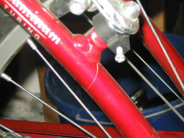

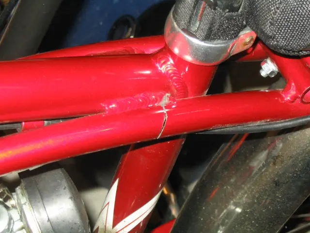

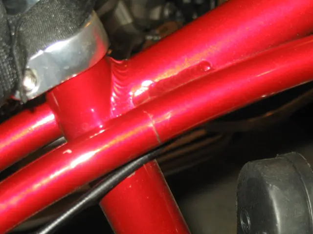

T-Dav: the cracks aren't on the welds, but near weld points. I'm wondering if the frame wasn't heat-treated after welding - leaving the aluminum brittle. Be careful out there.
-Pongo
Had to take some newer pics at lower resolution to send...

That was not many miles before cracks started....I had about 750 mi on an old Western Flyer and the weld where the cantelever bars and the seat post meet let go.

Yep - the cracks seemed to show up at about the same time. I know others are riding aluminum frames with way more miles on them, so I don't know if I just got a bad one or what. All I know is mine had a catastrophic failure in multiple places. I've already gotten a steel-frame mtn bike to build up & will be trying out the shift kit as well - can't wait!
