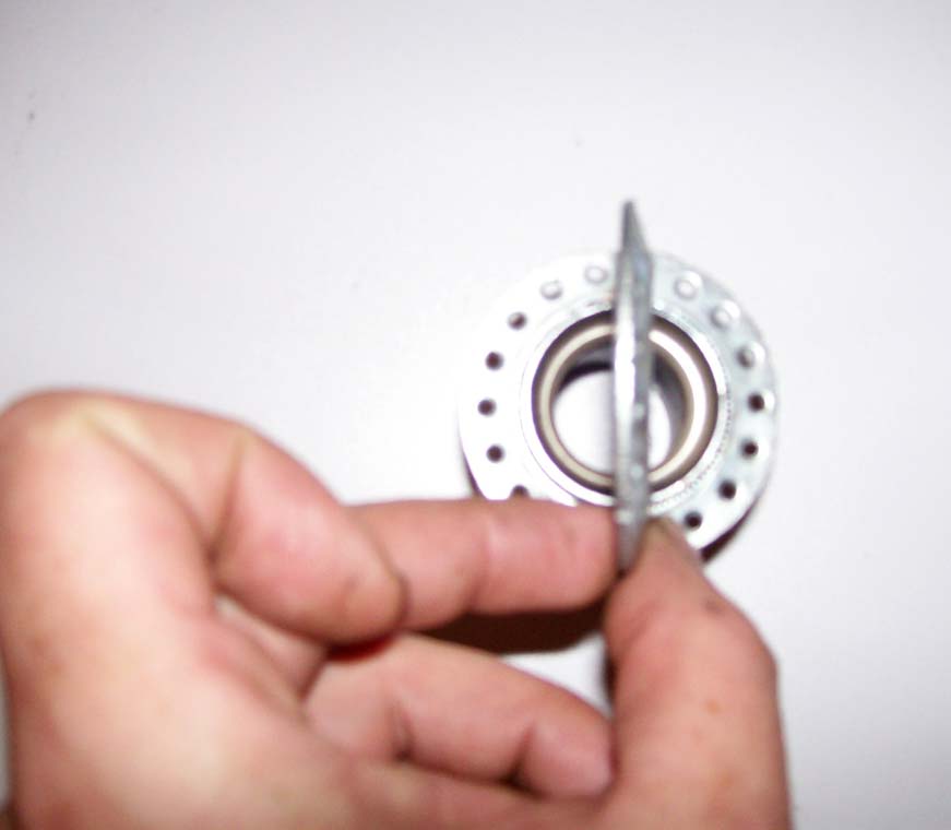

So I built this bike as an experiment and to learn how to make these kits work properly. I wanted to see if you could just buy a dept store cruiser, slap on a kit and go. Well it turns out you can. But I don't recommend it.

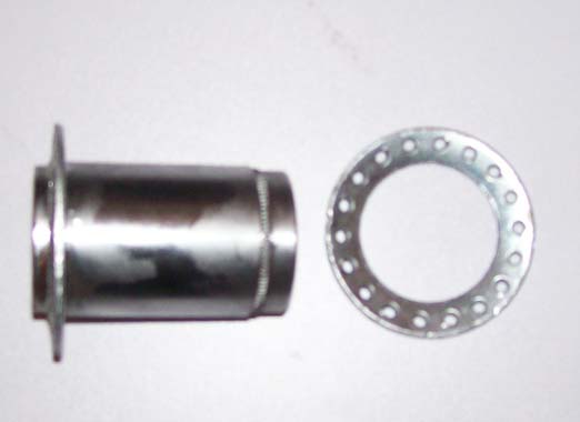

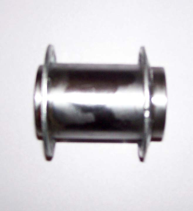

I've put about 80 mi on my bike since I built it and I've noticed the cup & cage style bearings are not up to the task. They loosen up regularly and can become dangerous fairly quickly w/o much attention. The steel components "are not made like they used to be made". As you'll see.
These bikes can be retrofitted w/ upgraded componants and modifications and be made to work ok. But I don't think it's worth all the $ and work it will take when you can buy bikes w/ quality componants that are overbuilt bicycles. And for not a whole lot more $
My kit I'm totally happy w/; my Schwinn Windwood Cruiser nasomuch!
don't get me wrong, it's a fine cruiser bicycle, and that's it.
I've learned so much and been introduced to so many interesting people and ideas since I started doing this. So my next bicycle is going to be up to the task!
Why Yes, That Is My Rear Hub!

Wow! it fell apart bummer. Some of the quility has sure gon down hill these day! Thanks for the heads up. Your cranks can be conquerd the cups have't settled into the frame? All the way I think.

I have the same bike from wally world sold as a point beach.(was $99, now 160 last I looked) It is funny how it is shaking it self apart. But dang she is pretty dressed up as an MB. The front fender is a boobie trap waiting to happen. The book rack succeeded from the union and the paint job falls off in a good wind. But she's pretty.
Tyrslider, that is great advice though, start with a good platform.

The modern coaster brake hubs are pretty much junk. Find a Bendix coaster hub from the 1960s or 1970s, overhaul it with fresh grease, and build it up into a wheel. The Bendix hubs are pretty great, and then came on all different kinds of bikes back in the day, so they're pretty common.
