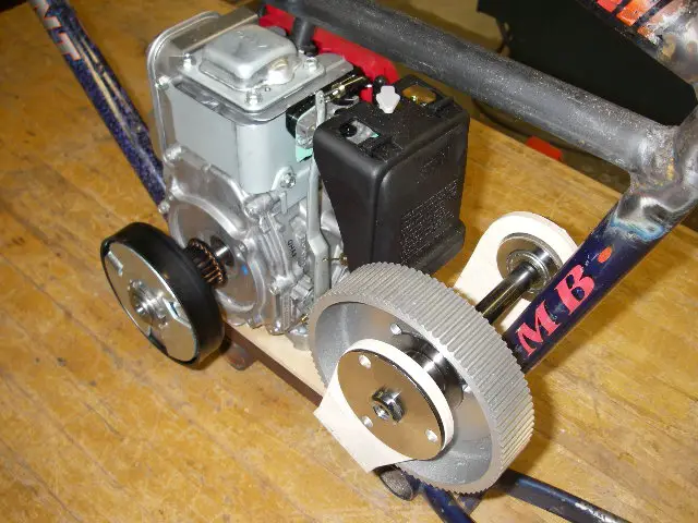

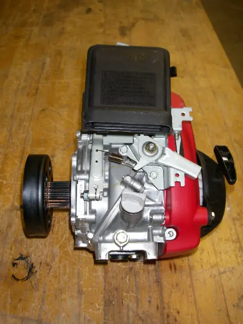

Possible helpful hint? I found when frame mounting a Honda GXH50 that it was very helpful to have a clutch that could be mounted to the motor with the driver inboard. With the driver inboard it allows you to keep the motor centered better in the frame and also keeps the driver supported better as it is closer to the shaft bearing. See photos below.

Oh snap Ocscully, That is gonna be pretty! The drive belt just makes it..dunno, just does. Might have to "borrow" the idea from ya. What ratio are you going with? With your set up and option of and option of placing the last sprocket pretty much any where, why is a "inboard" clutch necessary? Looks awesome. Will the peddles clear with your set up?
I really can't wait until you get that beauty finished. Is this to be your entry for the winter build? I am going to have trophys made. Thanks for Possible "helpful hint" (probable)

It's been quite a while since I ran the #'s but I think the total reduction comes in at 18.4:1 The clutch has a 23t driver to an 88t driven on the jackshaft to a 20t driver on the jackshaft to an 96t driven on the rear hub. Max speed as I remember should be around 30mph and it should cruise at 25 pretty easily.
Reasons for Inboard driver: First off the Honda Motor has a very short output shaft and just about any clutch you mount to it a portion of the clutch does not actually engage the shaft. Metric Timing Belts need a greater amount of tension on them for them to function properly and also due to the width of the belts I'll be using (20mm - 25mm wide) the driver portion of the clutch is what needs to be supported (closest to the output shaft bearing). Secondly the inboard driver allows the centerline of my motor to be within 3/4 in. of the center line of the bicycle.
What ever way you go with your project you need to be aware of the special needs of the Honda GXH50 or its Chinese clone when purchasing a clutch. First is the high idle speed (2000 rpm) you need to be sure that the clucth you buy engages around 2800 rpm - 3000 rpm. second you want to be sure that the clutch comes with the proper length output shaft extension bushing.
I bought my clutch from Max-Torque MaxTorque. They have a clutch specifically tuned/modified for the Honda motor, and also they were a great group of people to do business with.
