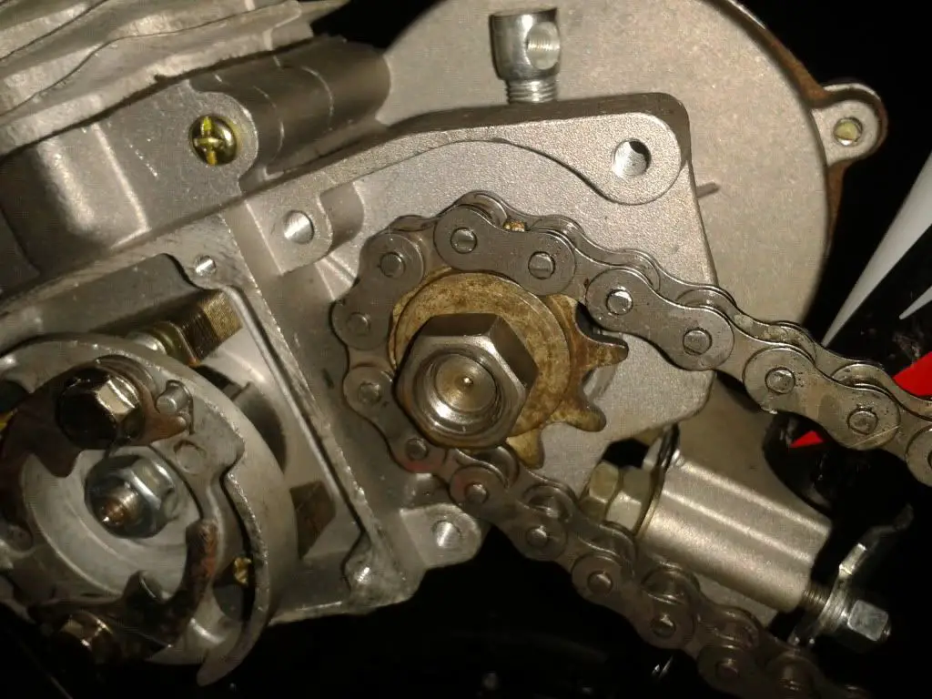

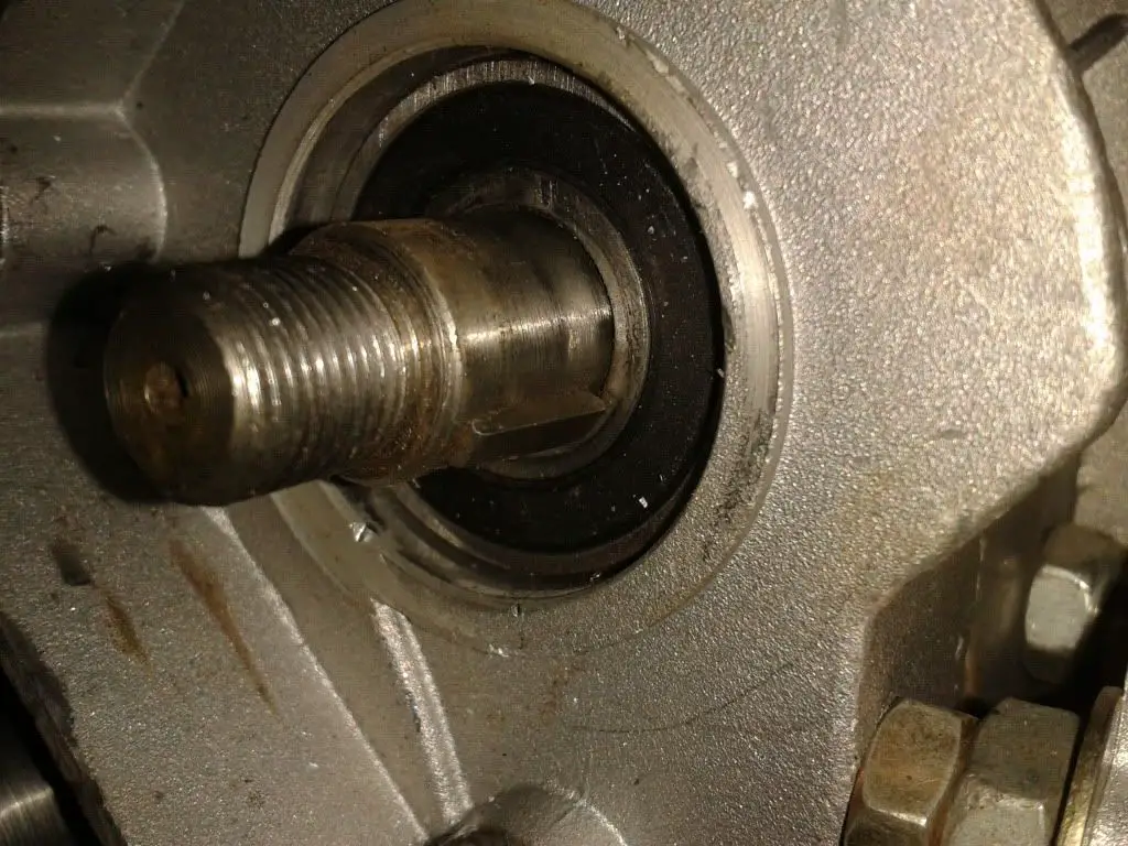

So my question is, how would i go about setting up a manual clutch lever in addition to the cent. clutch? what do i need and how do i install it? attatched are some pics.
this is the cover removed
you can see the shaft is just a straight threaded rod

Better fix your starter you ain't going to bump start it with a cent. clutch.
If you could get the correct parts you could replace the shaft and all the parts that go with it to make it a manual clutch. I think, I've never done it but I'm guessing it can be done.

Hm, the pullstart units are hunks of sh*t.
I was under the impression you could still have the manual lever to completely disengage the clutch, then drop it when peddling to engage and the cent. kicks in.
Alright, thankyou
