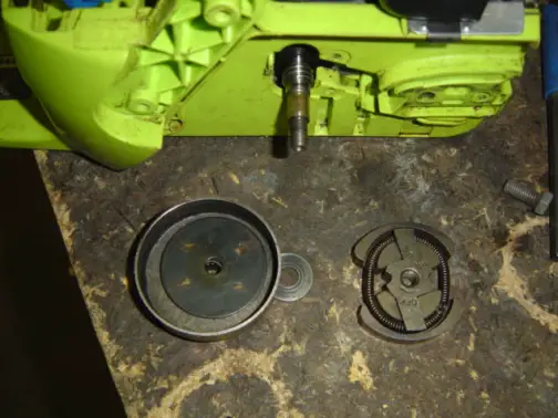

Okay your clutch is the nut. The 3/8 peg fits some of the ryobi engines. I thought it fit all the ones with a clutch but I could be wrong. It could be just the old ones.
If your peg is steel you are going to need to get the clutch assembly nut welded to the end of it. That way you can run the old clutch assembly threaded part back on and you have a drive wheel.
If you had the weed whacker that didn't come with a clutch you could use the adapter that bolts onto the drive shaft as a nut inside a pipe nipple end cap.
When you take your clutch assembly apart there will be a butterfly nut as part of the assembly that is what you need to have welded to your peg. I just bought a welder I will be able to do that soon I hope. That is once I get some experience.
Also on a weedwacker the threads are not backwards but on a chainsaw they are. On a chainsaw the nut that gones onto the drive shave can be anything. My poulan chainsaw has an 11mm reverse thread. It is the same nut that is used on the head of a echo trimmer. On the craftsman which is also a poulan it is 8mm reverse but the threads are weird or so they tell me at the fastener store. they didnt have it.
What engine are you using anyway.
Shoes uses a spring and turnbuckle to tension her engine.
By the way the clutch assembly comes apart to get that butterfly nut thing going.

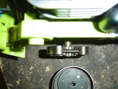

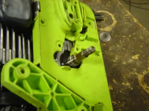

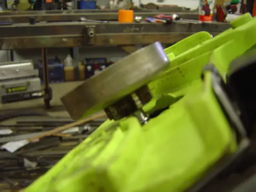

Okay thanks Deac. This is where im at, I went to a Lawn mower shop, King Bolt Supply and a Go ped shop and no one could figure out or had the thread size on the Shaft. I wanted to find a few nuts so I can change roller sizes rather then welding the cluth to the roller i have. Im posting pics of what I have.
My Poulan is Model # 2055LE 2.0CI 42CC.
On your setups, without using the clutch, do you have to engage and disengage the roller onto the tire everytime you stop the bike? Im concerned because there are alot of lights on my commute home.

Either disengage before you get to the light or you are going to choke it down and have to restart it. It isnt that much trouble once you do it a time or to. figure you are going to make half of them so you will only have to do it half the time. I just engage mine and roll up to the light. Then pedal a couple of times and start moving again.
Okay I had a very knowledgeable lady tell me it my small one was 8mm 100 thead size and reverse threaded. Now I can't swear to it cause I can't find that size nut anywhere. I didn't really look all that hard to be honest.
I also have an 11mm reverse threaded poulan that wasn't all that hard to match up.
Now i am told that the 42 is also a 5/16 very fine thread reverse nut. I can't swear to either one. I have a bunch of nuts I bought to try and haven't found one that fit yet. I do have one i haven't tried yet though. If I ever remove the drive again I will check that one is an 8mm 125 thread reverse. I think I already had one of those but it was worth a try.

Well the guys at King Bolt Supply pretty much have every nut and bolt you can think of and they couldn't figure it out. I guess the only way will have to be taking the clutch apart and welding the peg to it. I just hope i can get it centered so its not lop sided causing vibration.
I went to the goped shop and searched through the scrap bins. There are alot of the clutch setups for the small engines they use like the Motor bicycle kits they sell with the 4 bolt flange with the clutch plate mounted to it. But the shafts on those engines have a female end so the roller is bolted right into it.

I frankly don't have any other ideas about the clutch situation. The way I center mine is I run a quarter inch bolt through the peg then through the clutch butterfly. I put a nut and washer on the end of the 1/4 bolt then I tighten it down and check it and adjust it as centered on the peg as I can then have it welded. I guess when I start welding my own I will have to be even more careful.
but yes to much out of center and they will shake apart. I think I'm going to go back to weed eater engines. These chainsaws have the juice but they are also a pain in the butt to build with.

Yah, Its a bit more work then I expected. But then again its the first one. Im a welder by trade so be careful when you weld the nut on the peg. If there is too much heat on one side it might warp or be pulled to that side when it cools down. Better to start with about three tacks, let cool for a bit, then weld between the tacks. Make sure you sand all the coating off both the nut and peg so that you see shiny metal before welding to take off any oil or coatings. Any impurities in the weld and you will have a bad weld with popping and bubbles. I use a flap disk sander on my 4 1/2 angle grinder to clean before welding. You can get an angle grinder at Harbor Freaight for $18 which will do the job and is a great shop tool. If you are using Flux Core, no gas, I would suggest doing more then one bead because the flux will be more likely to crack with vibration. If you have a mig welder then practice the right speed, to gas, to volts on some scrap first. Practice makes perfect.

I rigged something up useing the clutch and peg. I found the matching clutch online priced at $5 so I was to afraid to weld on the one i have. I'll let you know how it turns out asap.
