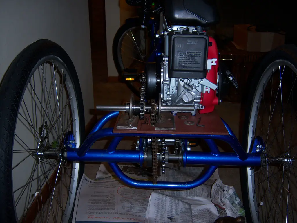

I'm in the midst of a build ,1st,one , but I'mounting the same motor on a Schwiinn meridian tricycle.Here's a pic of the gears.My threads in mounting techniques.You got a deal compared to what I paid ,where did you get yours I got mine a northern tool I believe paid $310.00 or so for it.

Kewl Mike! I am gonna go look for the thread. What ratio did you go with? I decided on 16:1 (I am gonna print bumper stickers that say "Got link?")
