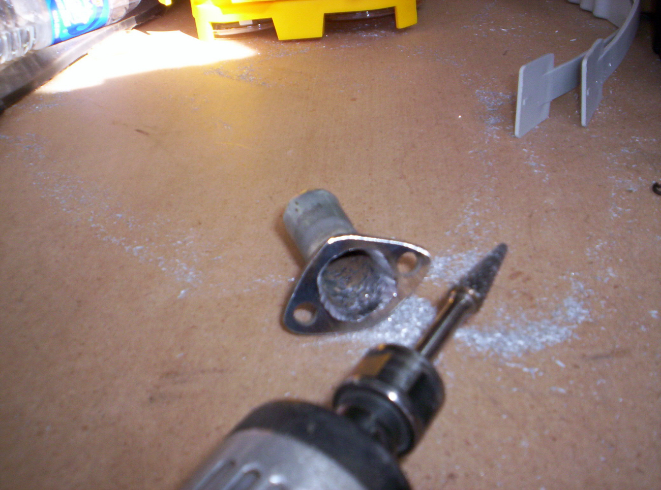

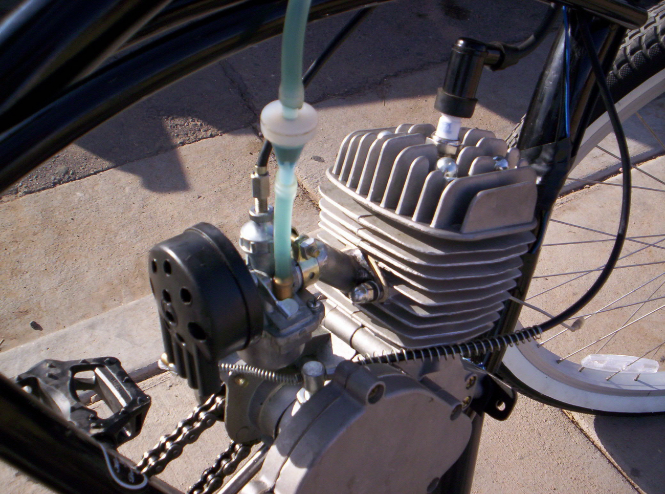

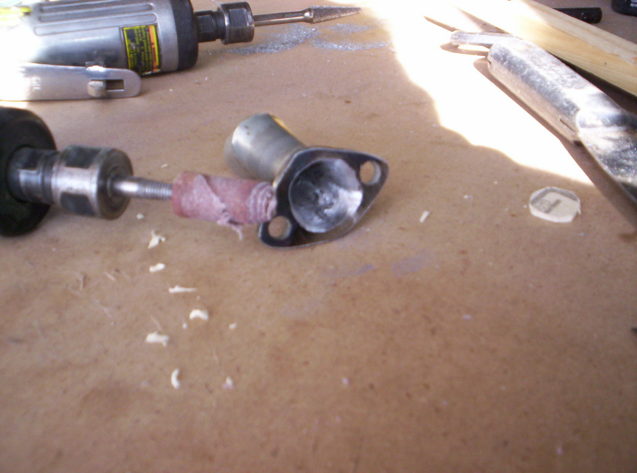

Yup, thats right, a big ole piece of you know whut... See what I get for trying to save some money?
Nice bike though, Firmstrong Urban 7 speed. The engine didn't have as much power as the Dax, so we ported & polished (it was badly needed).
Then it ran WORSE. I lightened up the oil mixture and it ran WORSE. I pulled the carb, jetted it out a little more, and it ran WORSE. Like it's starving for fuel
it goes put put sputter spatter. Changed the spark plug, no improvement. I may need to get a new engine.

Then it ran WORSE. I lightened up the oil mixture and it ran WORSE. I pulled the carb, jetted it out a little more, and it ran WORSE. Like it's starving for fuel.
Did you ever "read the plug" to get a baseline before you "made improvements"? Sounds like it's very rich. Lessening the oil and "jetting it out" both would agravate this problem. Have you check the float for proper operation?
I doubt you'll need a new engine, unless you've buggered up the insides somehow.

From the sounds of what u have described it could be a couple of things 1) carby jet blockage or size mite be to small now youve done the mods or neddle in float worn - not a perfect point (actually had this happen to me and engine would just not rev out) 2) cracked or broken spark plug lead( you'd be suprized how many times this gets expeirenced mechs. 3) exhaust mite not have correct resistence or lasty 5) check throttle cable to make sure opening butterfly/cylinder gate in carby fully
When I read that... I tend to think you should drill the jet a little SMALLER!
