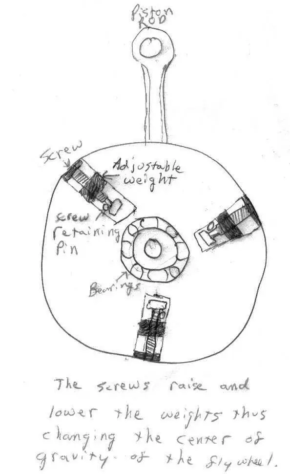

I had this idea for a way to balance the flywheel.
Name:	Crank Balance.jpg
That looks good.
I was thinking of a machine shop that does balancing on race motors? Cutting off weight and adding heavy metals like bigger cranks.

Good idea
I will visit a friend who has a big machine shop, has a dynamic balancer machine
He has experience with all types of racing engines, must know about single cylinder balancing
