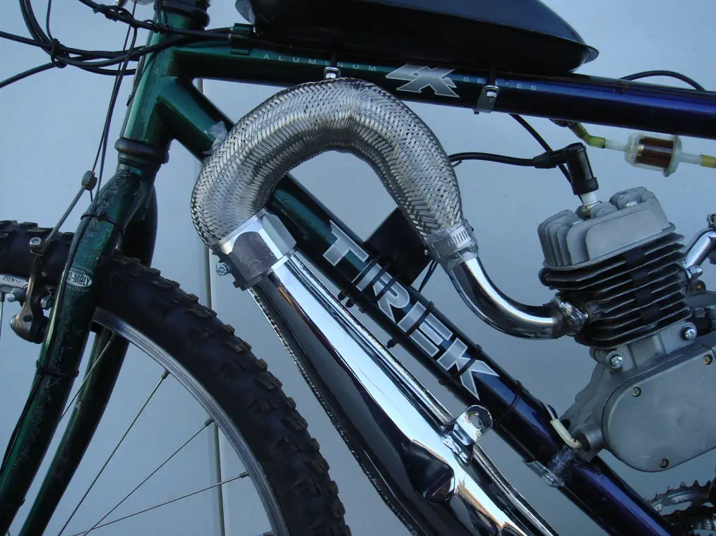

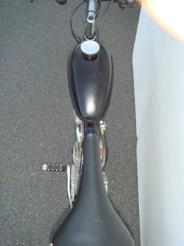

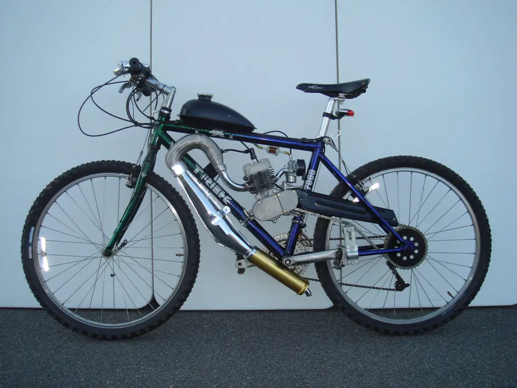

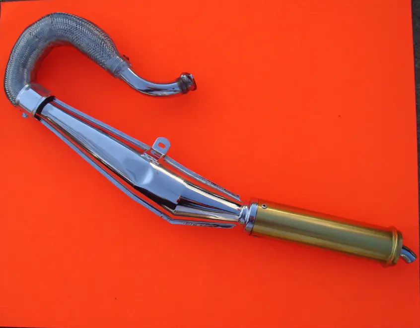

As some of you may know, I have been tinkering with making a tuned pipe / expansion for our little engines...Well I am happy to say I am 1 step closer to an actual production model....I will try to post some pics here now (this model is specific to the Dax 70 but may fit others as well).
The unit was designed the most difficult installation (small frame mountain bike, low rake fork, and over sized tubes) so it should fit on other bikes easily. The unit is adjustable as well without need for difficult bending. Weight is approximately 5.4 lbs. in prototype form. This pipe was designed to be far away from the riders legs so as not to interfere with normal pedaling and bicycle use.
Pipe will allow you to gear up substantially....It will pull me up the steepest of hills here in Charlottesville using a 36T rear sprocket faster than a stock bike with a 44T sprocket....I am thinking of gearing up even more in the future.
Andrew
