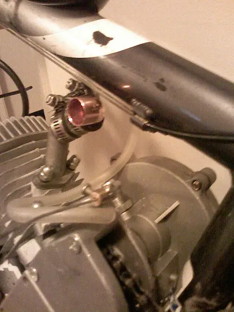

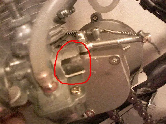

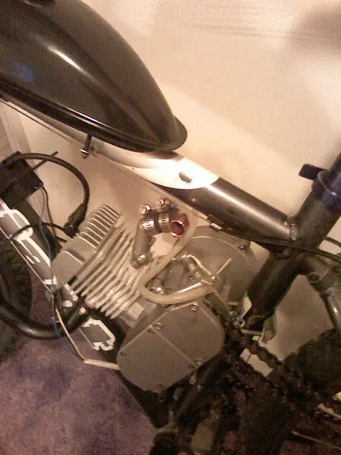

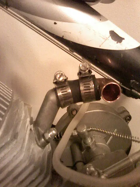

Unfortunately I have to ghetto-rig my elbow joint, hence why I was bending it in the first place. I couldn't find a way to get a simple 90 degree elbow from the engine to the carburetor. Here's some pics:
Edit: Sorry I forgot to rotate them around, just turn your head
Edit 2: Fixed them
