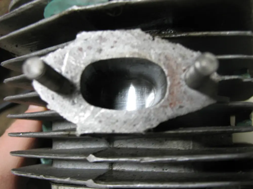

sounds interesting, can you post a pic of the exhaust port after dremel?....

Sure, I have another bike that I will also port out the exhaust so I will take before and after pics of the exhaust and intake.
It may take me a few days though...

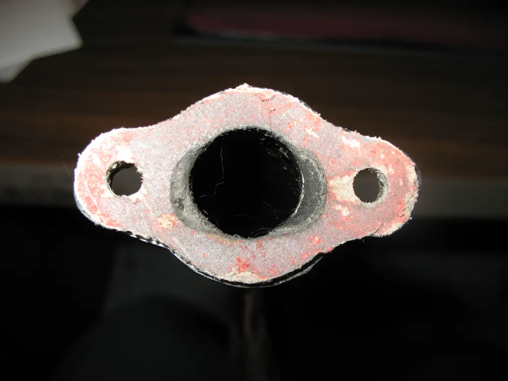

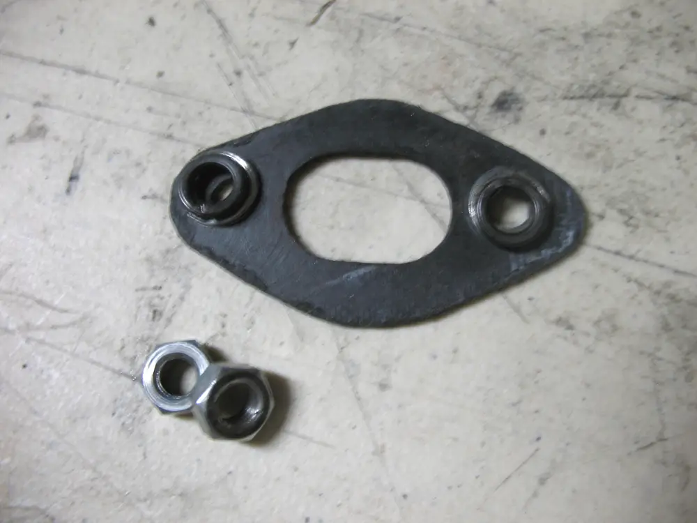

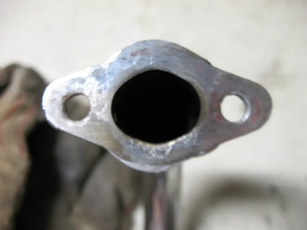

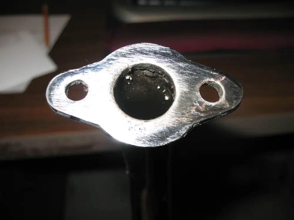

Here are some before and after on the stock exhaust before I added the tuned pipe. First is stock exhaust and gasket. Second is stock exhaust. Third is exhaust port. Fourth is new gasket. Fifth is new exhaust manifold. So I start by creating a new exhaust gasket using the exhaust port as a template. Then I use the new gasket as a template for the exhaust manifold. Then repeat for the intake side.
