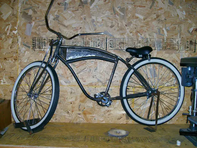

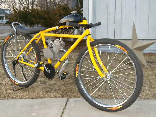

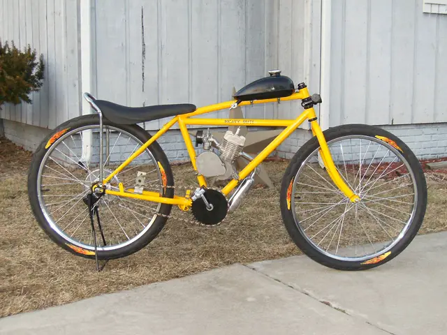

This is my little work in progress. Still have alot to do but its a start.

very cool bike

Love the color. Looks like the spark plug boot is going to be a tight fit. I know they make a plug with a shorter profile, not sure of the part number.

How didya hook up the handlebars?

Nice bike. Is your engine the same that is on the derringer bicycles?
Derringer Cycles Home
I am a little confused with their statement that they are honda 4 strokes on their bikes 49cc.

Just a little more on the bike. The handlebar setup was just something I dreamed up one day to see if it would work. The steerer tube is threaded all the way down. I cut out everything I could between the upper and lower bar. Threaded on another set of steerer tube bearings and mounted the mini stem in the middle. The main problem is finding 3/4 inch dia. bars now.
Just trying to get it back together and test a few things before I finish it. The motor is an 80cc I bought off ebay dont know where it came from. But Im mainly putting it together to make sure its going to work and then I'll finish everything else. But I also have this to finish so who know...its a Firestone super cruiser.

You gotta make that in the frame looking tank hold the fuel if not may the Gods of speed frown on you............................ Just yanking your chain. I like the bike and think you should make it work for fuel. Good luck on the build.
