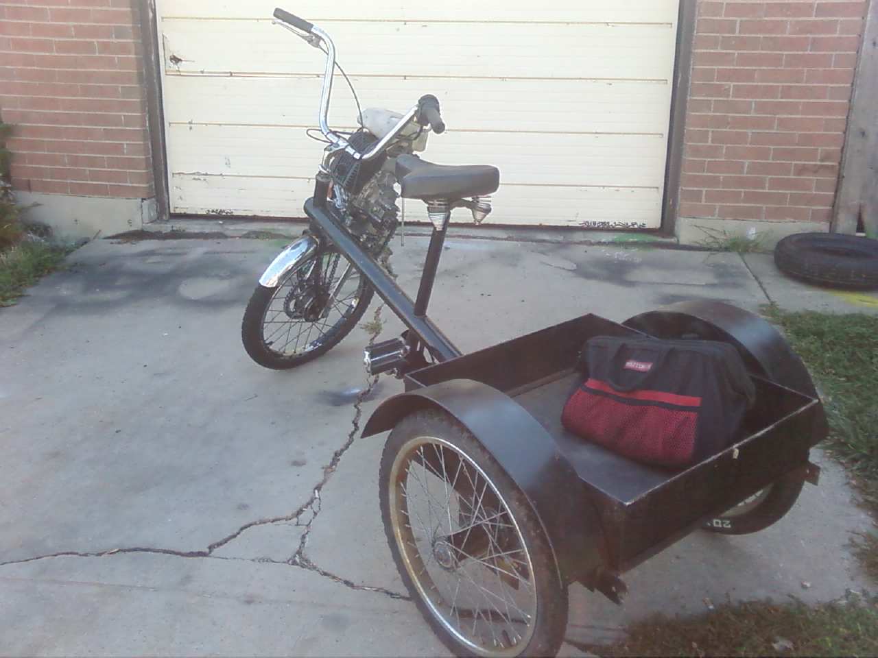

I got Duanes new assembly the other day! All Chrome!
So working on it,getting it on Cronus so what to do with the old assembly?
Well,put it on my trike,that's what.
Pics below. Only 5 I'm allowed. They'll be more.

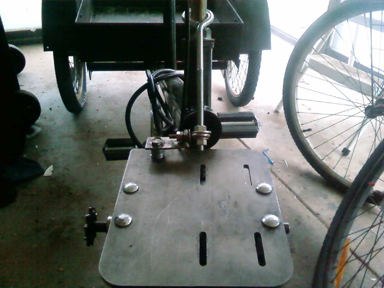

First pic: Not only is the new assembly on the left chrome,look at the extra holes! You can move your plate back and forth now for a more universal fit. And even the torque strap holes are on each end. Basically you can't go wrong installing just make sure the jackshaft is on there right.

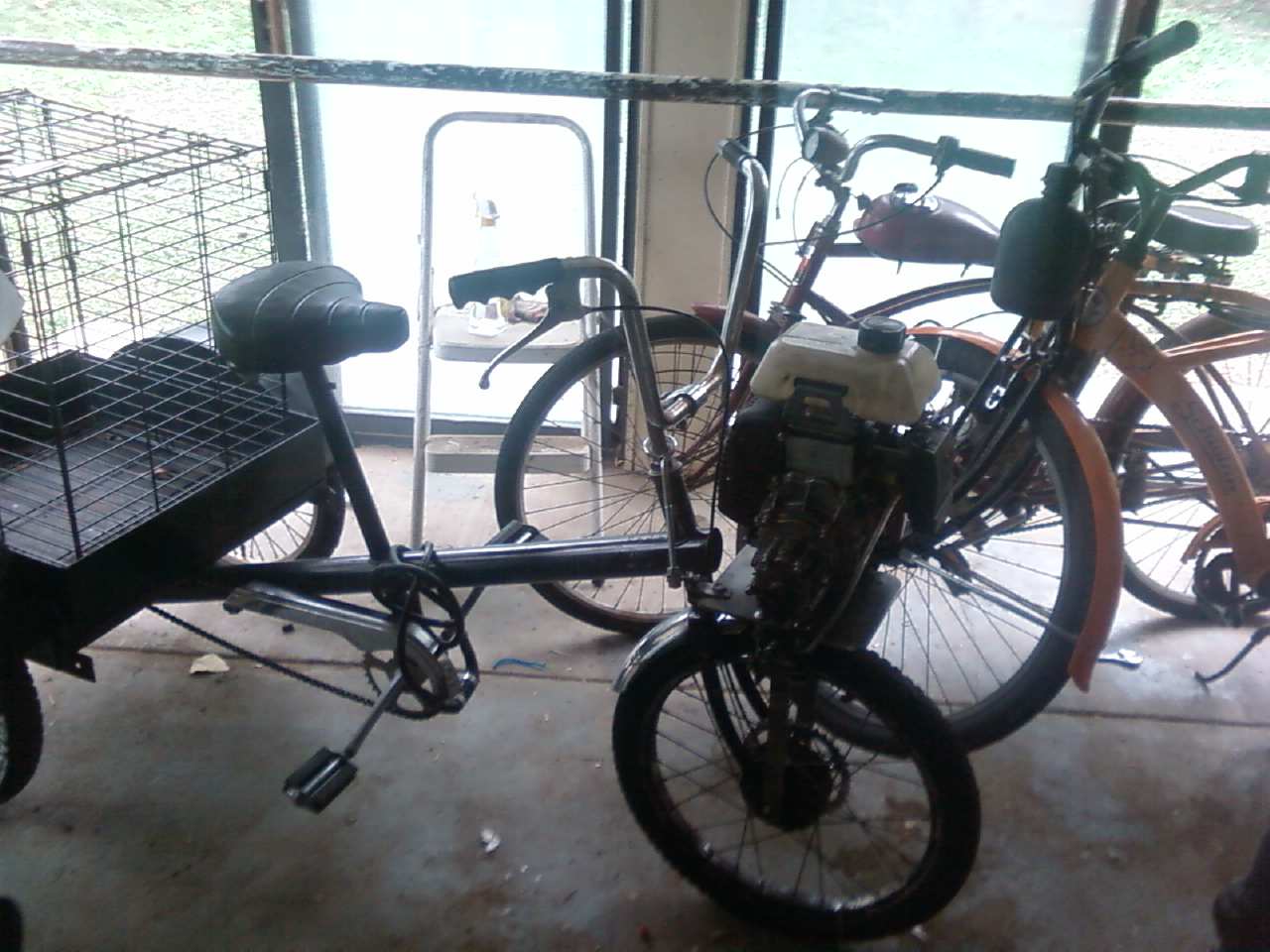

Pic 2: How my trike sits. That's a 20 inch wheel up front. 40 tooth sprocket from my donor BMX bike drilled and bolted right on the drum hub no spoke mounting epic win! The Titan carriage holders fits right up to the axle. Pretty cool,huh. Just had to open up the holes slightly.

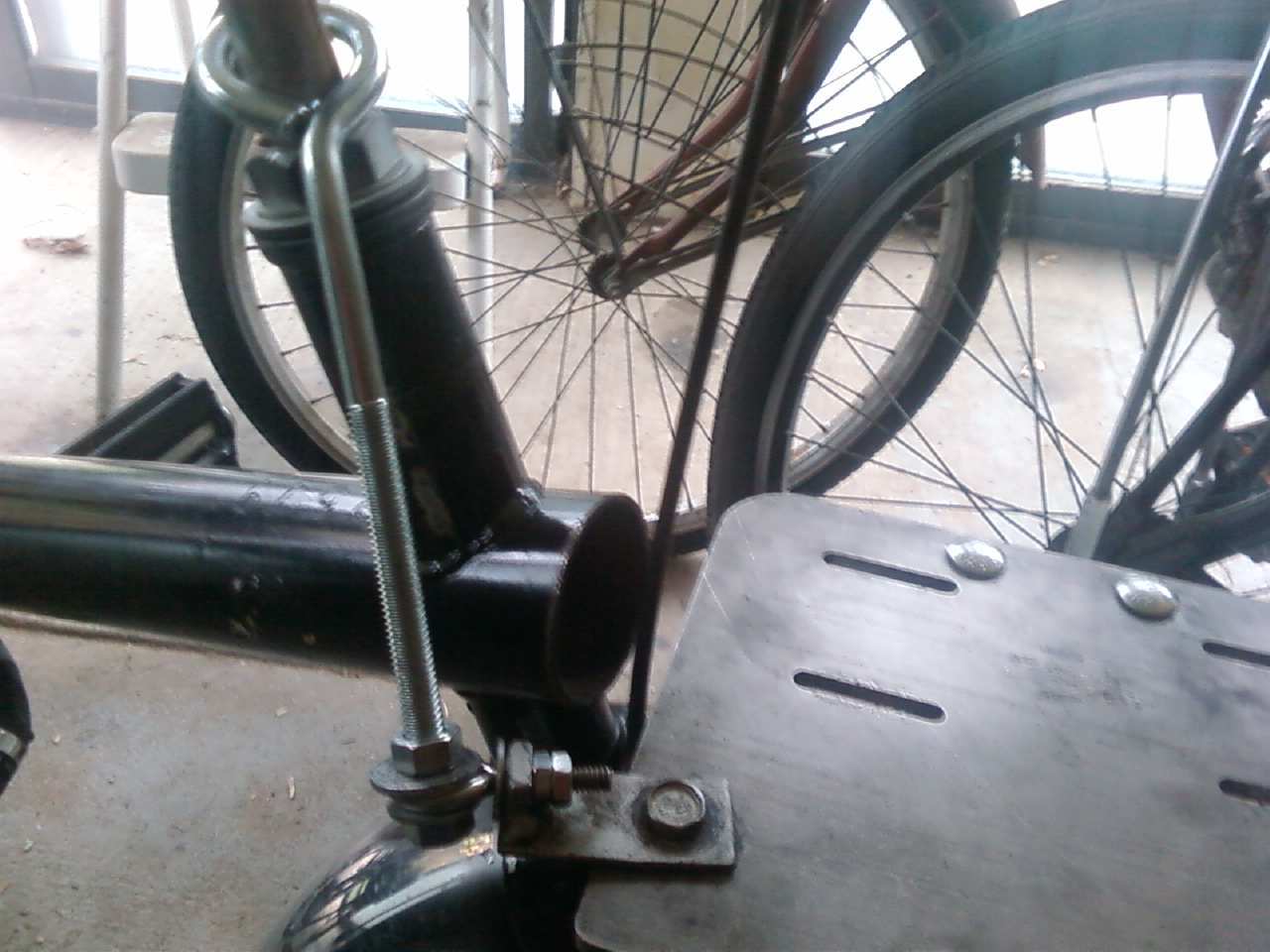

Pic 3: First brainstorm to the Torque strap. Acquired from Lowes under 2 bucks. Notice how the gooseneck moves with the entire assembly so the bolt never moves except with the entire assembly.

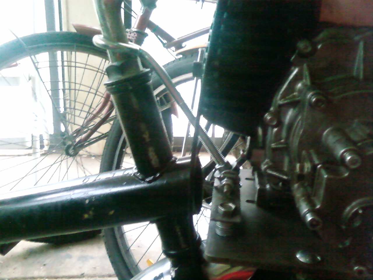

Pic 4: Look at how the engine sits. Nice and low! Exhaust comes out below my knees.

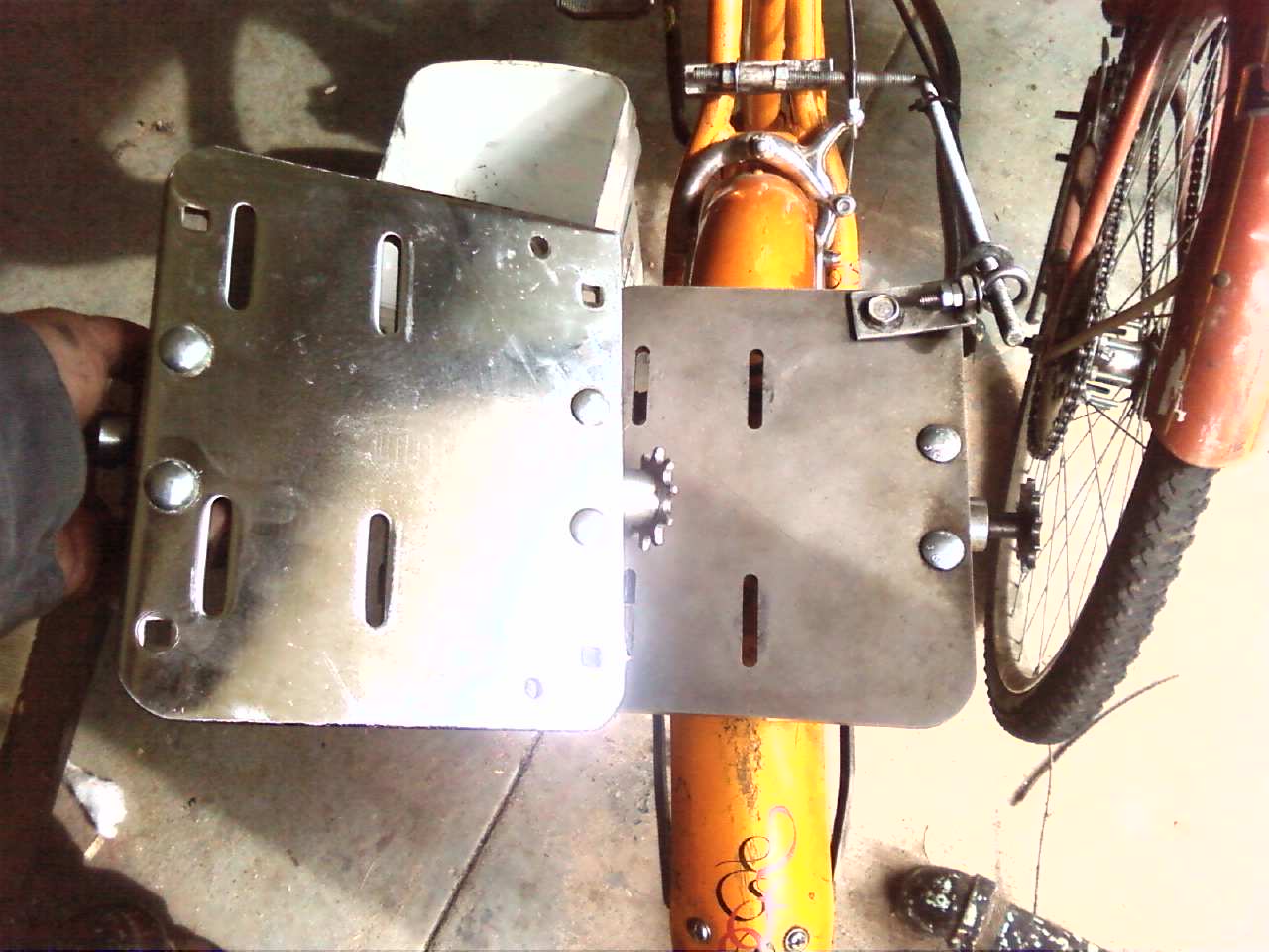

Pic 5: A better brainstorm on the Torque strap. Yes. I think I like it there!
It took a little while to get the money up for the chrome carrier so for now I'm sharing the Titan engine among both bikes. Now saving up for another engine!
I had to flip the old carrier upside down meaning remove everything,flip and install everything up again just so I don't have to drill a hole for the Torque strap.
Things I have yet to do. Remove throttle assembly from Cronus,install new throttle assembly,try out Duanes extended throttle cable. Put old throttle on my trike I can shorten up that cable rather easily because on the end I have a cable pincher made for the chine engine clutch cable.

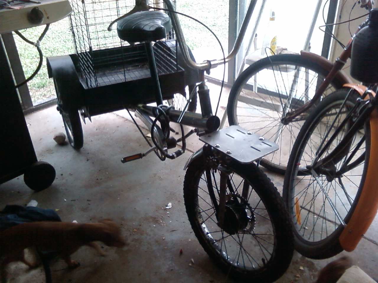

Here's a couple of pics.
First pic is the bike from the rear.
Second pic is a closer inspection of the torque arm.
To make the torque arm stiffer I screwed in a screw between the torque arm and the gooseneck.
More pics tomorrow.
