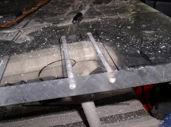

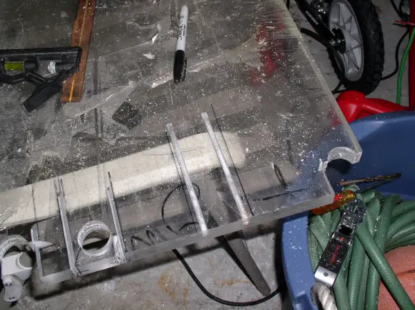

Way ahead of you brother... It was the motor mount and I in the process of fabricating a new one out of 1 inch thick plexi glass... how sweet is that?

I have a couple of the Chinese two-stroke angines, and they are buzzy little engines. You won't get away from the vibration too much. I'm afraid the plexiglass mount might ultimately fail due to the vibration.
The steel ones on my bikes have lasted for quite a while without problems. I broke the original cast ones right off the bat while tightening them. Dax has unbreakable steel mounts available: Page Title
To help dampen the vibration you may also want to take a piece of old innertube and wrap it around the frame where you clamp the mount.

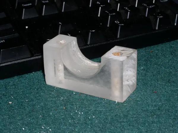

This is a bullet proof window I had left over from a bank install... 8 times stronger than steel... lol Took about 1 hour what do you think?
looks good. i think is should be pretty solid as long as you keep the bolt tight. have you replaced the mount bolts with high grade bolts yet? i have not done so yet but i will be shopping around for some high grade steel bolts tomorrow.
