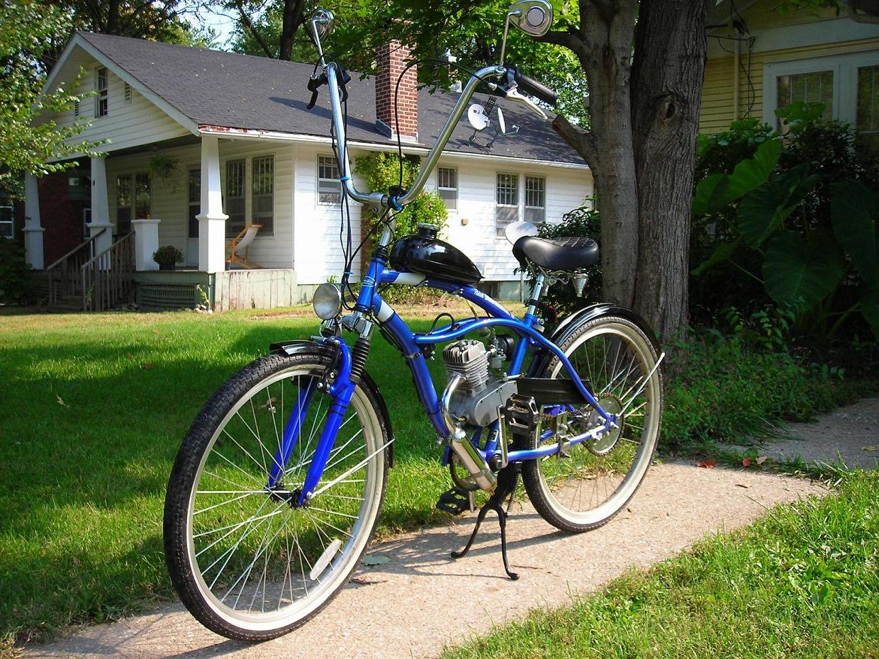

My bike has a front and rear light powered by the white wire. These lights came off of a vintage bicycle generator system. Both lights work fine. The problem is, the light bulb filiment breaks in about one week of riding. I have rubber dampers between both light mounts, and it still occurs. Each bulb is a 6.3 V. Plus these lights were meant for a bumpy bike ride by design. My front one is mounted on the front fork. The rear light is mouted on my saddle. Anyone else having this problem? I wonder if their is a H.D. 6.V bulb that will resist breakage from vibration?
