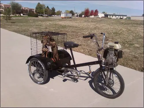

My trike has a sprocket from a donor bmx bike. 40 tooth. I plan on using the 36 tooth currently on my crank and replace that with a 44 or 46.
So yes. It most definitely works.

Hi
Pics
44t sprocket (before)
36 t sprocket (now)
It cruises at a higher speed w/o vibration
Had to mod the brake lever, I'll post it in another post
