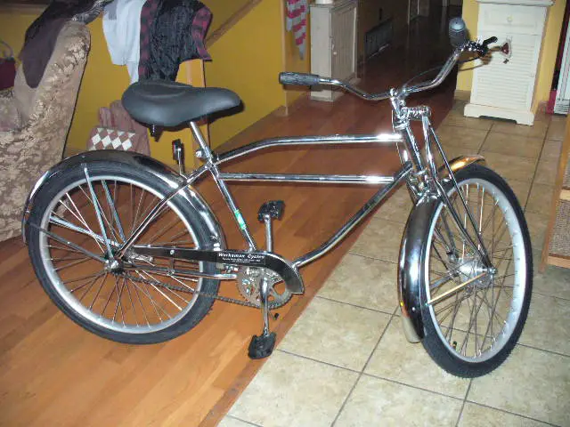

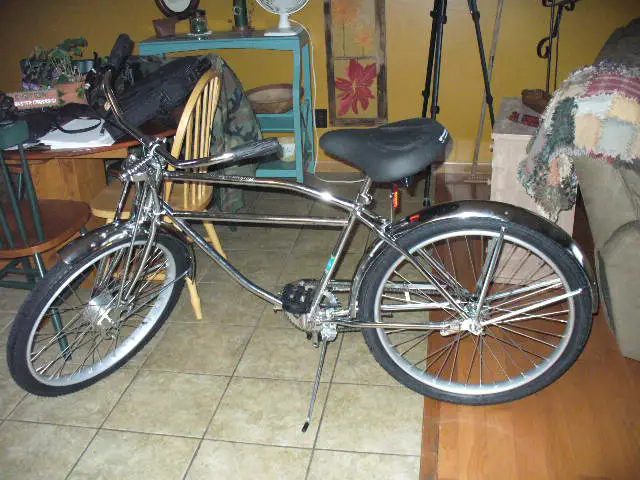

Well I've finally received my Worksman from the factory. They're very backed up these days. I've given up on the in frame four stroke now that I've been able to take some measurements. Looks like Happy Time for me. Question for the ones in the know? I have 12 1/8 inches from the top of the bottom bracket to the horizontal tube at the seat post and 11 3/8 vertical from the bracket to the tube. The drawing that's around indicates 11 inches. Spookytooth's website has the same drawing but in their manual they indicate 12 1/2". Anyone think I'll have problems putting a HT & an SB Shift Kit on this bike?

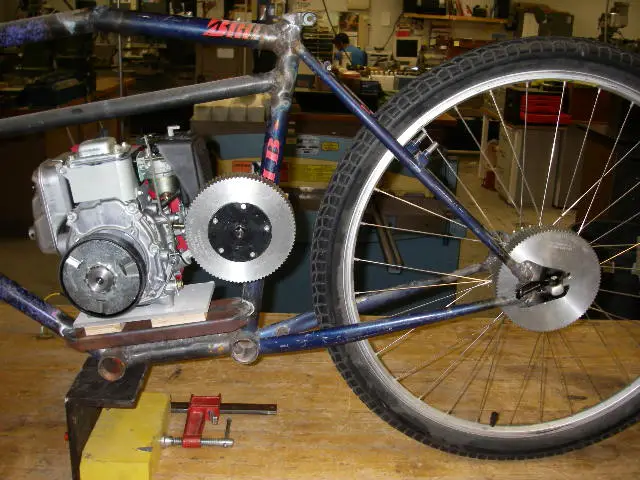

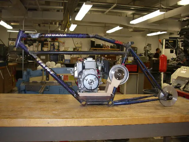

I'm curious as to why you think there isn't enough room for a frame mounted 4-stroke? based the dimensions you provided and the photos I think you have plenty of room for a frame mounted 4-stroke, assuming we are talking about either the Honda GXH50 or its clone? The Honda Motor is only 10 ins. tall without the Tank. I feel that if your first choice is a frame mounted 4-stroke Honda/clone its still more than possible with the bike you have.

Below are a couple of photos showing the GXH50 sitting in the frame set I've thrown together for my project. When I was still in the planning stages for this project I too considered the Robin/Subaru 35cc but opted instead for the Honda due to its higher HP & Torque as I'm pushing 250 lbs. And pretty much the only frame mount kits and accesories are based on this motor or its clone. It turned out that I've ended up putting together a totally custom drivetrain for my project rather than buying a kit, so the second consideration ended up being a moot point. The Subaru 35 is slightly smaller than the Honda GXH50 wich is a plus, but there isn't a whole lot available in the way of reduction gearboxs available for the Subaru. There is one 3:1 reduction gearbox available from a supplier of pocket bikke engines and accessories that would fit the Subaru, and there are the gearboxs made for Viza Motors that would work as well. The other area where I felt the Subaru came up short as a frame mount is when you get the tank removed from the bottom of the motor there are only two threaded mounting spots to attach the motor to your mounting plate. I didn't feel this would provide a solid enough mount?

Oscully - Your two frame combination and custom drive train is most cool. I'll be watching your build with great interest. Thanks for the Viza information. I was unaware of their gearbox. I've been considering the pocket bike one, Staton's 3.11:1 compact or their 18.75:1. The Viza box might just be the answer. It has nice lower plate for mounting. I've inquired by email to them for dimensional & ratio information.
