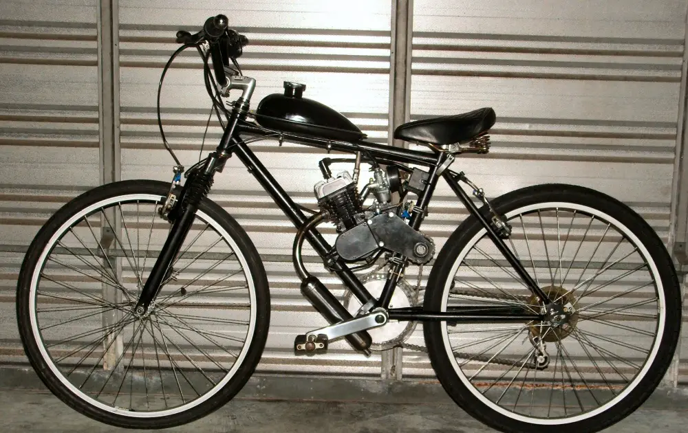

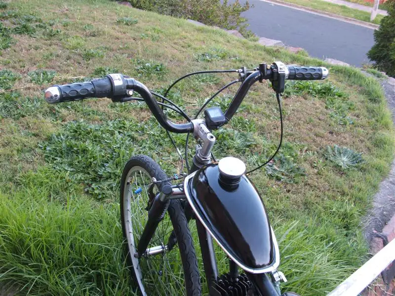

After my first shifter bike was stolen (i was gutted by the loss) I went ahead with version 2
All I learned on the first build was used in this build.
http://motorbicycling.com/f15/shifte...html#post35547
It features:-
A new needle bearing 70cc painted black
Alloy rims and slicks
A head-stay
Suspension forks
Low seat & high bars
Twist grip 6 speed
An adjustable "keeper" to secure the back wheel
Dual action brake lever
It is so reliable, I have put 50 miles on it without any major mishap.
Just regular issues with cable adjustments.
Future enhancements will include:-
A real Dell'orto carb probably a 16mm SHA
A pocket bike pipe
Fenders and lights.
Possibly go back to a 3 speed hub so I can shift when stationary, been caught out in 6th a few times at the lights!
It is geared to do 19mph in first and 38 in sixth at 6000rpm
It pulls out to 35mph now, should pull over 40 when run in.
I'm happy to do 6500 for short bursts!

I love the lines of that bike!
Nice - what brand twist shifter is that?

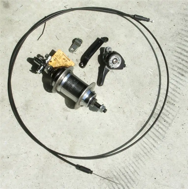

Thanks for the compliments guys, the shifter is called Epoch.
It came off a mid range Huffy as did the wheels and some other parts.
But look what I got today, All new old stock, made in Japan Shimano parts.
For $25!
My Local Bike Shop has a pallet load of them.
I plan to blow 'em up one by one!
But they are pretty robust parts.
And no more getting stuck in 6th when stopping.

nice! that looks like a hub i pulled off a bike that was bound for the dump. is that a Shimano 3.3.3.?
Old 09-30-2008, 12:10 AM
wildemere wildemere is offline
Join Date: Feb 2008
Location: Newcastle
Posts: 269
Default Re: Shifter Bike v2.0
Its a 3S with all the correct accessories

Nice! I have a six speed with a 70CC on the Pulse-Kettler bike in the pictures section. I have been looking at the Sturmey Archer 5 speed hub. Steel or aluminum? Is this the strongest internal hub you think?
Old 10-02-2008, 10:09 PM
Join Date: Feb 2008
Location: Newcastle
Posts: 269
I have experience with only 3 speeds, The SA model AW and the Shimano 3s
The sturmey is quirky but solid, it has a neutral between 2nd & 3rd and if it gets stuck there and the power hits then blammo... It also has the fragile chain gear selector.
I prefer the shimano, no neutral and a sturdy bell crank.
