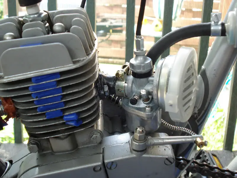

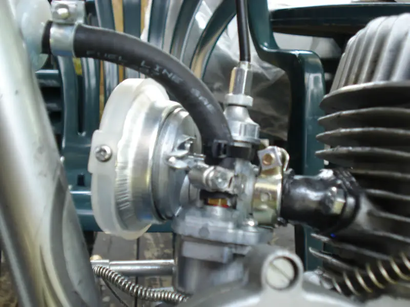

This is Norm http://motorbicycling.com/members/norman/
He made a short manifold for me t5hat goes off to one side and it works great

Old 09-30-2008, 08:00 PM
Norman's Avatar
Norman Norman is offline
LORD VADER Moderator
Location: pampa texas
Posts: 2,673
Default Re: intake manifold?
would a manifold like that work for you? Jersykat1
Now you know who is Norm
Norman
norms-iron-works.tripod.com

sorry off topic a bit, i the intake pics i see blue silicone tubing , i think ?, between the fins. does this help much with vibration? thanks. HEY!! DO A WHEELIE! hill climber
Yes, what exactly is this?
