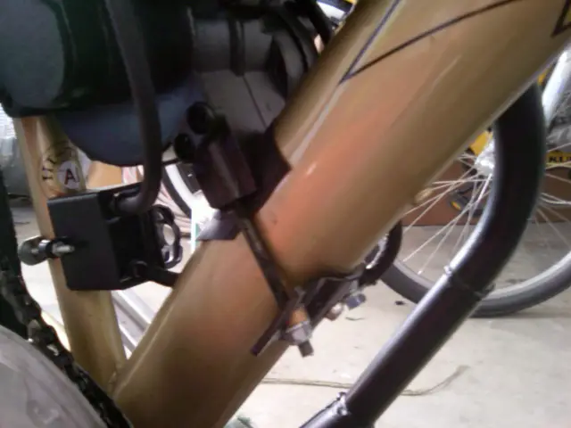

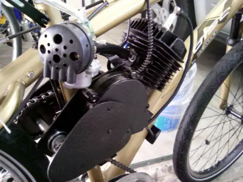

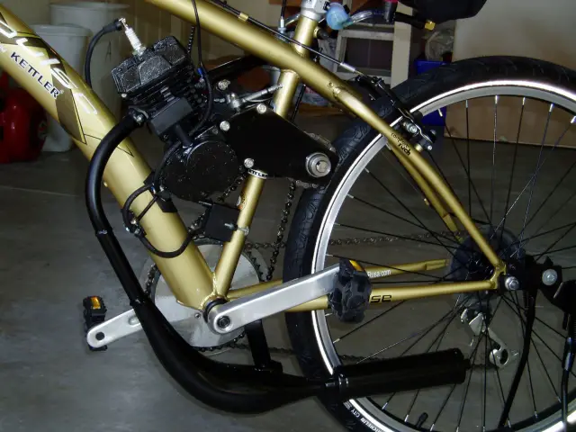

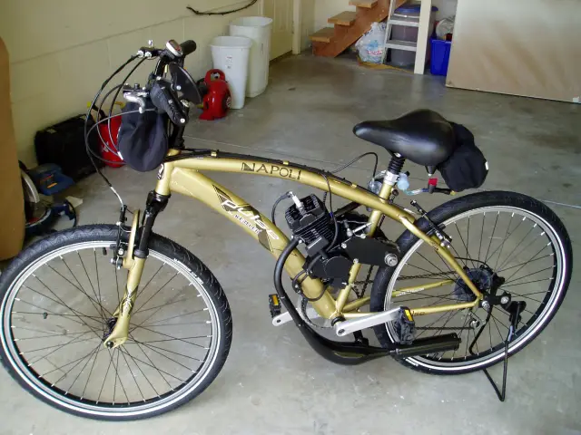

I ordered this bike online because I liked it (a lot)! I thought I could get an engine in there maybe. If not I would send the bike back. When it arrived I opened the box and became sick. I got my engine and held it up to the bike and it would not go in the frame at any angle. I called the bike store I had bought it from and told them I wanted to return it. Long story short they needed around $100.00 to take it back. I then put it on eBay and tried to sell it. After five days and no bids I decided to try the engine in the frame again. I stripped the mounts, studs, sparkplug, manifold and carburetor. With the front mount shaped to fit the down tube and the rear mount gone I was able to fit it in at one angle with very little up and down clearance. You need some to adjust the chain on the shifter kit. I rough shaped the front mount with a wood rasp which worked really well. I formed a piece of tin to fit the tube perfectly and embedded this in the engine with cold weld. I cut the rear mount down to about 1/8" and reinstalled it on the engine. While the cold weld was still soft I put the engine in the frame so the angle on the front mount would be correct. After this dried I filled in the voids on the front mount with more cold weld. It seems to be a very solid mount. There is less vibration on this bike than any of the others I have built. I can't say for sure it is the mounts but I think they help. On my other bikes the front mount sits on a plate u-bolted to the tube.
The rest of the bike went together with no major problems. I wanted to run 2.125" or more on the tires but was limited by the sprocket on the shifter kit to 1.85". I have a set of the 2.125" tires and they are wider and taller. There is maybe 3/16" clearance between the tire and the sprocket now. I rode the bike for a while and decided I needed black rims. After I changed the rims and tires the bike rides even smoother. I think it is because the rims are truer with better bearings. They spin forever. A lot longer than the originals. I think the tires are truer ( if that is the correct terminology) as well.
I added the pipe last. The engine only had about 150 miles on it, but the pipe still made a significant difference. It will continue to improve I hope. I made the head pipe 12". I don't know if this is the best length but that is what it was from the factory. Others on the forum have suggested this length as well. With a little over 200 miles on it the bike tops out at 36mph.
It has six gears. My other bikes improved with mileage hopefully this one will also.

Simply WOW. Proof that these kits can fit ANYTHING with some thinking.
I would never think it would work.
I do see a weak point.
Your front motor mount bolts. Keep an eye on them.
But because your mount hugs the frame on the ends maybe it would be okay.
No room for washers,huh. Washers run across the bolt would strengthen it.
Are the bolts at least a grade 5?
(edit) Woah! I just saw the pull starter! NICE!!

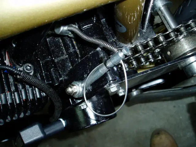

Large... he has so many details that make it look good! I-Paint What did you use to put the wiring in?

you know, the tight fit makes it look like it was made to fit. that's a good looking ride! don't you love the different frame geometries the bike manufacturers are coming out with these days?

Thanks Large Filipino, Those are all thread studs used in the front mount. They go through a plate that fits the bottom of the down tube. It is actually one side of a chain idler so it is pretty heavy before I put the self-locking nuts on is a small tube spacer cut at the angle of the plate on one end and square on the other. This keeps the stud from trying to bend to the angle of the plate across the tube. It is probably 45 degrees or more.

Thanks Motoschwinn, That is wire loom I got from https://www.thehotrodcompany.com/sec...eipt_id=292589. You see it on old cars. I also bought some copper sparkplug wire from them.
Large Filipino, The nut you see on the bottom of the front mount just holds the wire clamp. There is another one under it that holds the mount. I wish I had better pics.

I think I see it now. VERY NICE! Nice job indeed!
I hope you don't mind my input. I just love how you did all that particularly how you tackled the carburetor.
Just an insight that's all but if you flipped the intake manifold over so the carburetor is on the left then you can finagle with the choke while your right hand is on the throttle!

REAL NICE job. Great chain tensioner.

Thanks Large Fili I welcome any and all insight. I didn't know how the long manifold would affect the engine but it seems to run fine.

what did you use for the intake manifold? how did you extend it like that?
