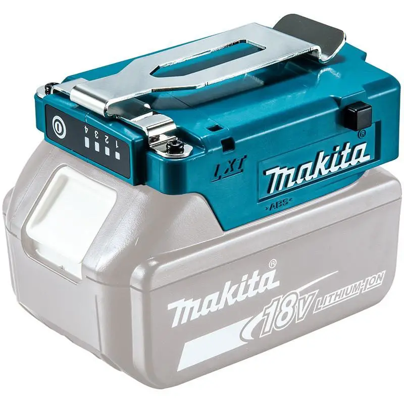

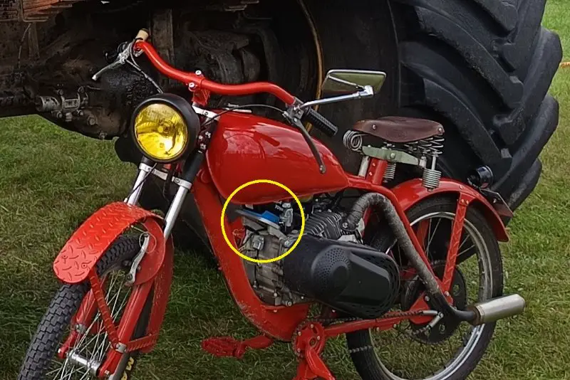

Hello, I strongly recommend choosing the CVT TAV30 variator, it is the best solution. For lighting, I also considered this solution, and chose to use a MAKITA 18V battery, because no one alernator will produce enough electric current for normal lighting. I installed a car LED low beam bulb, the light is impressive, and the battery charge is enough for a 3-4 hour trip.I found a place under the tank and installed a Makita adapter for quick and easy battery installation and replacement.
