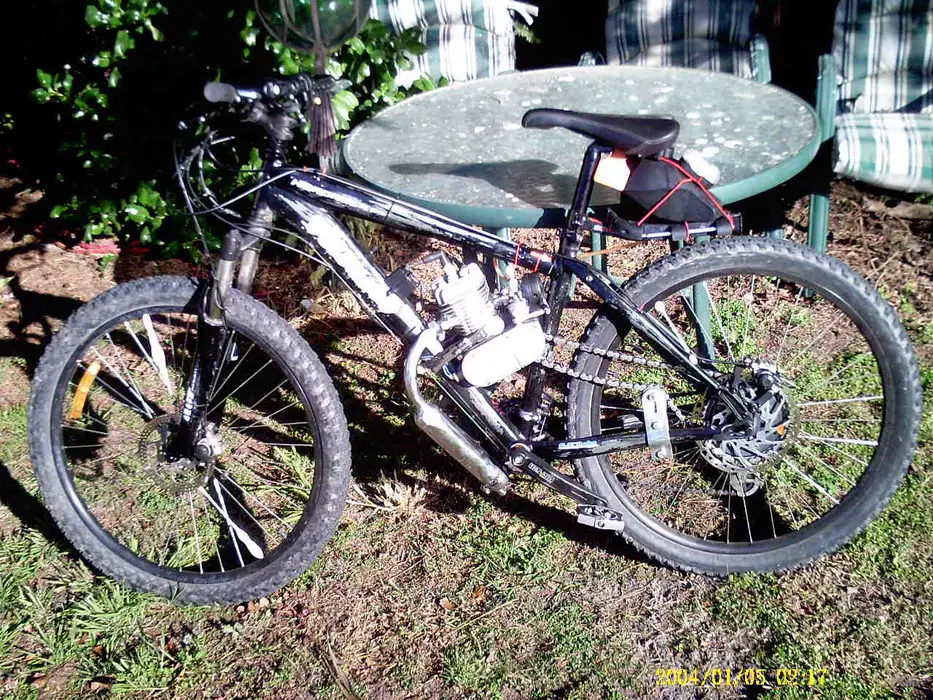

One other question. What is the difference between a Ryobi like motor and the motors that are set in between the frame rails with the long cylinder, like the Expedite 60cc which is sold by ThatsDax? Like the bike in the pic posted.

The two stroke in the photo is from the china kit. Cost between 150 and 200 for the kit. You can do what you want including climbing that hill on the way to work with one of those. I have no idea if you will get stopped by the smog police or not. Possibly you will.
