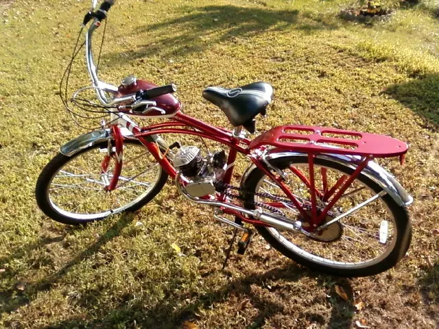

OK, I got the long pipe back on, and sealed all the joints with muffler leak sealant. This bike runs perfect now! I've ordered a Testors brand paint that is supposed to match nearly perfectly with the Schwinn paint. That tank is driving me nuts!

Performance for me was the same, and just a bit quieter. Make sure you have it well secured. Check the flange when you get it make sure there are no cracks in it.
Looks great MS. Did you have to custom fit your pipe? I have heard that is a common problem. I got lucky with mine, my frame is slightly stretched and it fit like it was made for the bike. If I was using a standard frame, I think I would have had to do some bending. As for preformance, it is pretty much the same, it does change the sound of the bike, and for me the bike is much quieter because the sound is behind me...Kelly
It seems to me that the "poopoo pipe" would be a better suited pipe for out engines. Longer = lower RPM range of tuning.
Do you guys that have them have better low/mid range throttle response?
