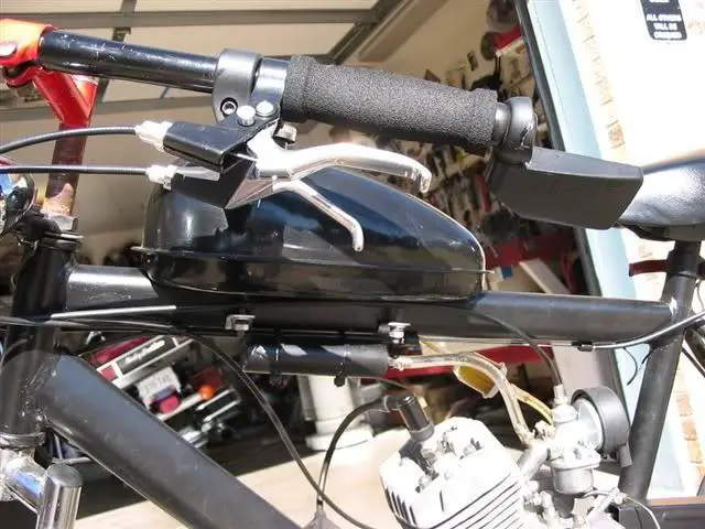

Hi guys, I would like to tell you something I've learned from an old farmer, and that is "don't NEVER put all yer eggs in one basket!". Up till now I've not heard of an accident, but figure this, you break that lever, or injure that hand and you now have exactly NO brakes.
I don't like the geometry of Mountain Bikes, in part because I have no interest in looking straight down at the front tire, when I should be driving 3-4 carlenghts (actually bike lenghts) in front of me.
When I did build a couple of mountain bikes I used the rotary clutch handle locking the clutch on left, front brake right lever, rear brake left lever. I still have some of those rotating clutch handles in stock! Then I changed the bars for "touring" or "cruiser" type, and the saddle to "Touring" now the MTB is pretty close to a hybrid type bike.
I will never build a bike, relying on only one lever to stop it. I have actually at times, considered putting a caliper, or other rim pull brake, on coaster bikes just as an extra saftey measure.

I have to definitely agree with Mike on this topic.
The what-if's of having anything happen to that single brake lever leave to much to my over active imagination.
If you mount your clutch lever over your front brake lever, you can quickly become accustomed to using your front brake as you pull in your clutch. I instinctively pull my front brake with my first finger or two as my clutch lever gets pulled in...the rear brake I seem to use a lot less but it is still there. If the brakes are adjusted properly you don't need much travel on the lever to get them grabbing on.
With having a MTB with front suspension you can hammer on that front brake pretty quick and hard and still not do any endo's...even at 30-35 mp/h.
Personally, I would never put my trust for both brakes onto one lever...just to many bad things run thru my mind when even thinking about it...scary, lol.

Hi Lone Ranger, I am an experianced motor-bicycle builder. Did you notice that the pic of Old No.6 that I posted here in this thread started out its life as a Ladies 10 speed mountain Bike?
Furthermore, I used the rotary clutch on it, along with the 2 handbrakes which were the origional topic.
Functionally there is very little difference wheather bike is 10, 12, 15, 18, 21 or more speeds. In some cases it becomes necessary to remove "people sprocket? derailer mechanism, if it will hit the engine, elsewise raise the engine.
It's all rather simple, really it is.
