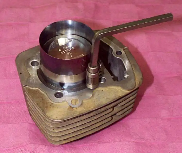

They do make a tool called a ring compressor....but I have never needed to use one on small applications, I just use my fingers
