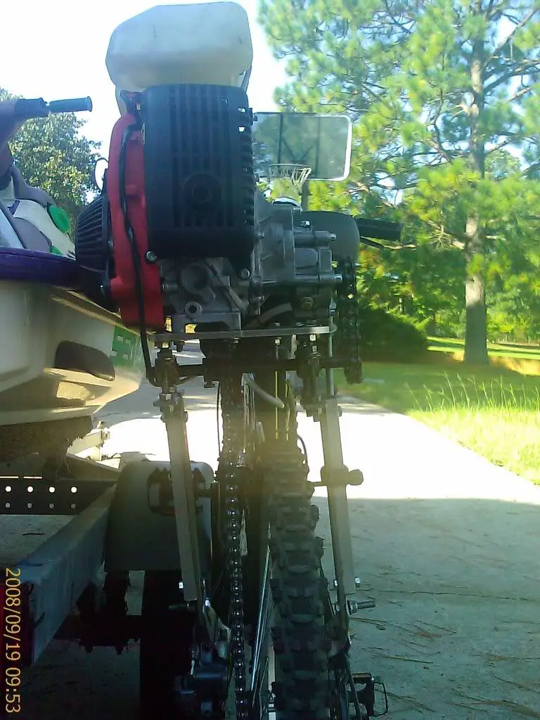

well I had already straightened and reinforced the carrier as I stated in the first post, those were just some old pics after the wreck... I took a new one today I'll post below but still need to do some aligning. The right bracket it sitting lower than the left so I need to change the bracket location on the swingarm to even them out.

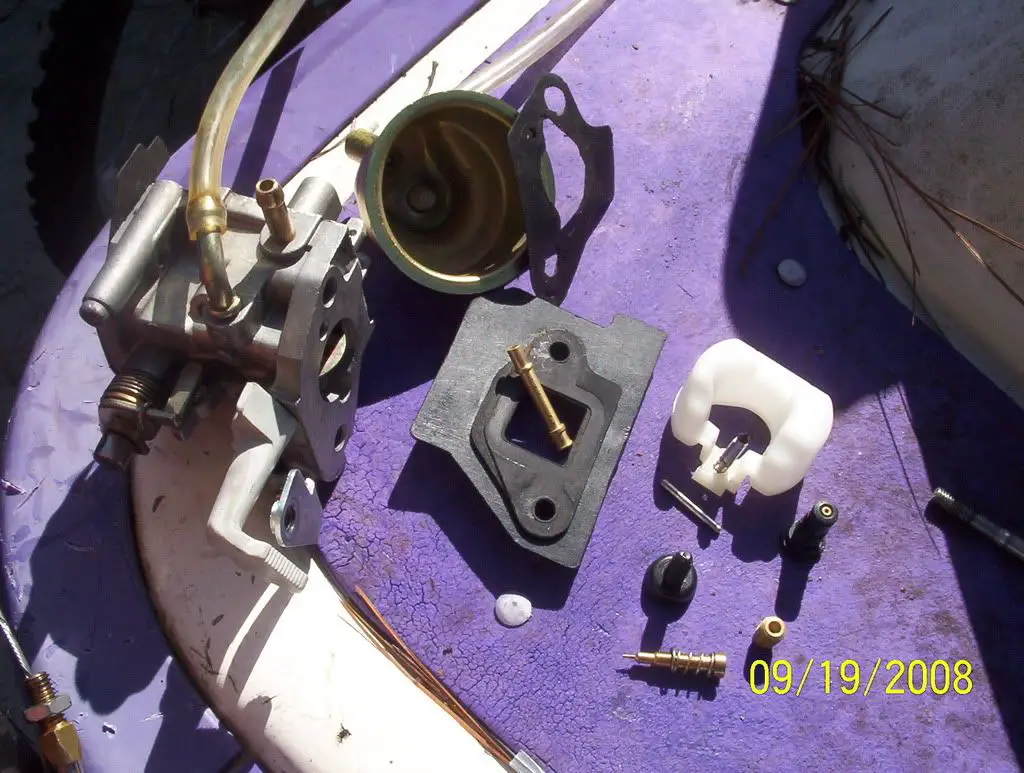

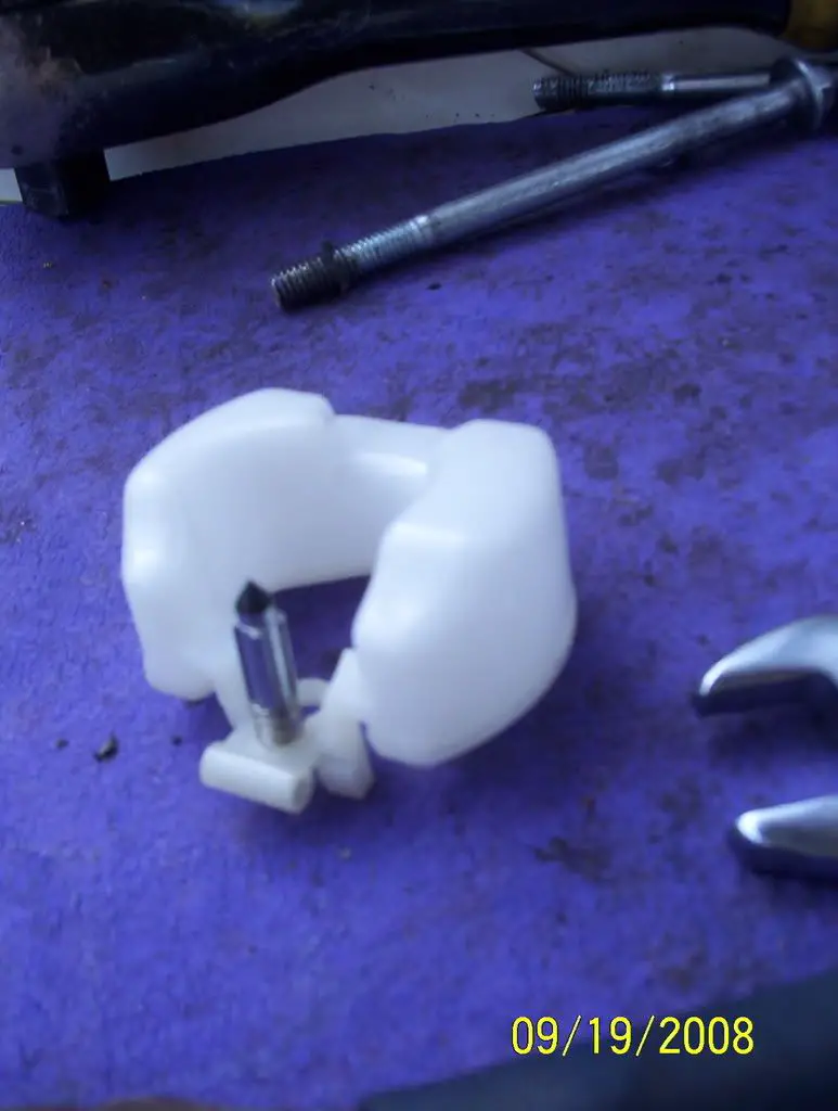

I took apart the carb and carefully inspected the float and all seemed well. I even blew into the fuel feed and could not blow air through went the float needle was engaged so I don't think that was the problem.

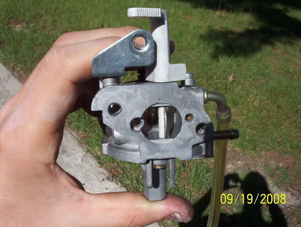

Reading some others posts about idle issues and the gaskets, I checked all of them to verify alignment/etc. The gasket between the filter plastic and the carb didn't line up to well, so I trimmed it carefully and then took all the parts/pieces of the carb out and cleaned them ALL again.
Carefully put it back together (minus air filter) making sure to align the gaskets and it cranked right up with the choke like it used to. Soooo, I let it run for a min to warm up then slid the choke to open and it kept on going as it originally did when I got it. I picked up the rear end and revved it and ran great, and it didn't die when I left off the gas at all.

reinforced carrier (still needs to be aligned)
float
choke side of carb
All carb parts removed...

Float leaking/filling up?
I think when you crashed, you may have affected the operation of the float and it's sticking itermittantly.
