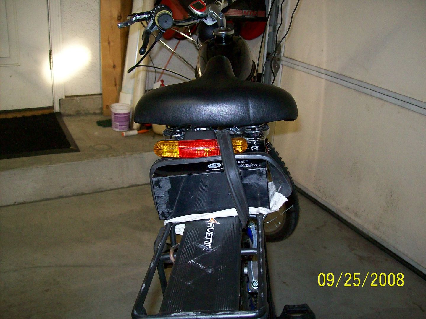

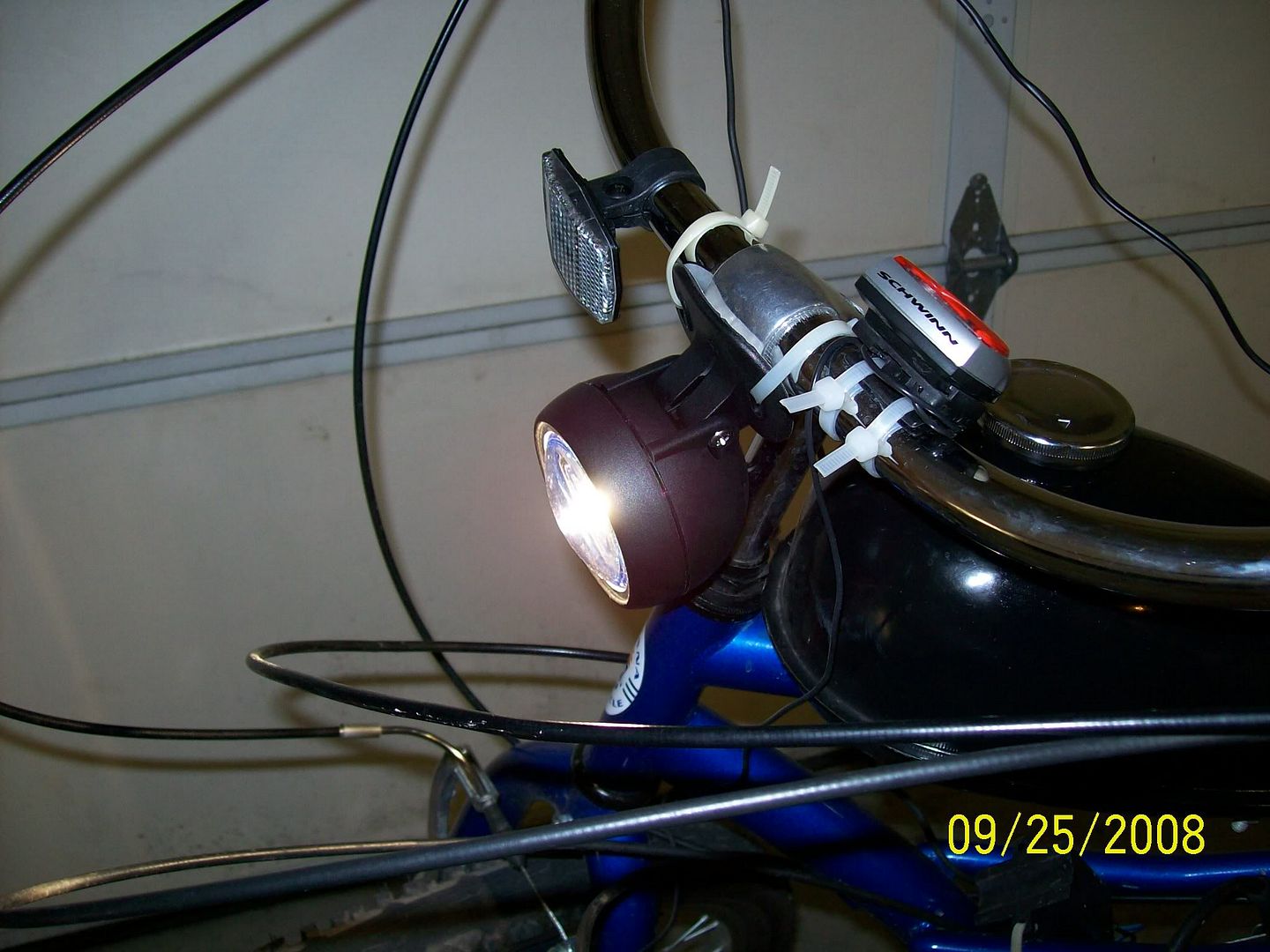

The light setup. 55watt light 12volt 12 Amp Hour battery

Tyler, where do you keep the battery on your bike for that cool light?

Default Re: Pics of my $7.50 Moon Dog w/ 70cc HT
The battery is on the rear rack, under the taillight. You can see it in the last picture, it's that shiny black box.
Is that a rechargable battery? and where from?
