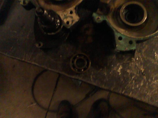

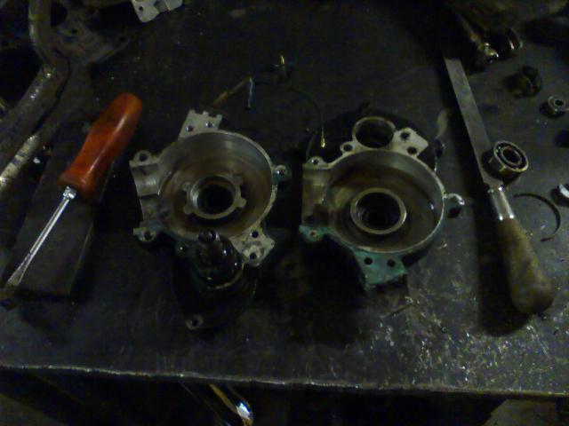

Default main or side bearings are 6202
the countershaft? bearings are 6202FS which just means they have seals on both sides
the main bearings I believe had single shields & that they were put toward the inside which starved them for oil, one of them was really dry there was shields between the main bearings & the flywheels on both sides some of which escaped & got dragged around the inside of the case a bit by the flywheels on both sides :-)
I took pics of the inside of the case & the bearings
there is no de burring at all with the castings so there is allot of potential for case material sluffing off & getting cought up in the piston .....
on the rod Im not sure I think the rollers may need to be measured
I looked very carefully at the lower rod bearings through the slot in the bottom of the rod & they look Ok as well the play in the rod is mostly vertical & not lateral so IM thinking the rod is stretched & that the bearing is Ok
Ill edit & ad pics later
take care
JAK
PS I did get in touch with the supplier & maybe hopefully he can be of h elp somehow
thanks for the condolences :-)

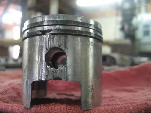

Jak,Also sorry to hear you had that problem. I had the same problem with my 50 cc about a year ago, rebuilt it and it seized up again. My 70 cc and my Titan both run flawlessly. I never could find a cause for the seizure and the consensus was bad porting since the damage was only on the port sides of the piston.
Good job for sticking with it and finding the solution.
