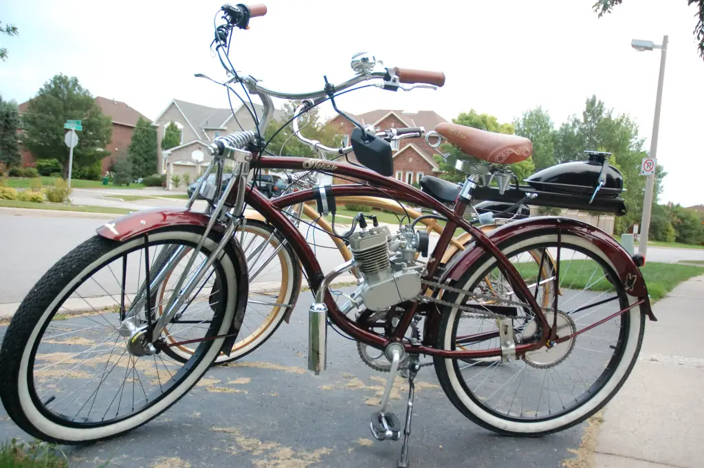

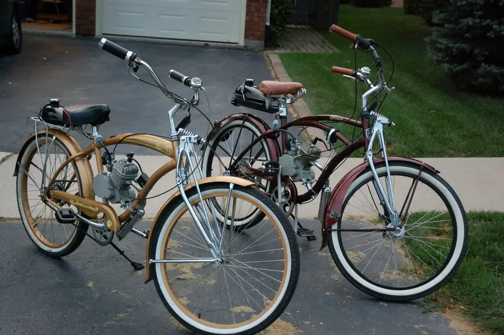

Has anyone else had problems with the cdi's?

I live in the GTA, And i have gone thru 3 CDI boxes on 1 bike???
COuld this be a problem with my bike or the way the CDI's are made?
I noticed other CDI's for small engines have heat syncs to cool them down and ours are completely shrouded in plastic, could this cause the untit to over heat and short circuit?
