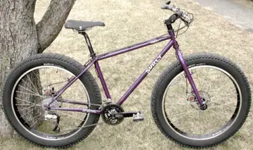

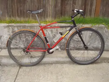

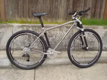

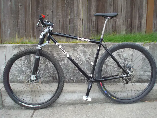

As far as there not being enough room in the triangle that is not true. The frame per given size, and there is a range of sizes available from 16" on up to 24", has plenty of room in there as evidenced by the attached pix. The black bike is about a 19" frame that I ride @ 5'11" and the silver one is about a 17" frame that is my wife's bike and she is 5'6"es. Plenty of room in there for a motor. There however is not enough room on the wifes say for a sickshaft but I could get one on the black bike because it has horizontal drop outs and I can slide the rear wheel back enough to get the clearance necessary. The red/black bike illustrates the double top tube dilemma that is faced even on 26" wheeled bike in some designs because the drive tube makes the triangle smaller and I don't think I could get a frame mounted motor on that bike, but an electric system would work no problem.

While there are few fat road specific tires for 700c rims there are certainly enough to make it worthwhile. The original 29" tire is the WTB Nanoraptor and it is a great street tread and to this day my favorite all around tire. Visible on the front of the red/black bike. A company named Schwalbe makes a 2.35 slick that is HUGE and has for years, it is named the "Big Apple". But if you want huge huge then go with the 26" 4" tires as seen on the purple bike, they measure a little over 28"es. Can you say dunebikey? Bikes like this compete on the Iditarod trail also. I hope to motorize one here soon also.

Years ago when we were looking for sus forks that would work with 29" wheels, as the cast lowers on all the available forks would not clear them and new castings were expensive, we searched the aisles of Interbike in Vegas for anything that might cross over. In 2000 we found this fork which was marketed by LOOK, a french company and perhaps most famous here for their sponsorship of Greg LeMond in his heyday. But the fork was manufactured by Fournales another french company that makes dampeners primarily for the aftermarket, kind of like the Curnutt of France.
Because all they had to do was stick a longer tube on there we thought Voila! But alas it never came about until they no stopped making the forks about 4 years ago and they sold off their remaining stock cheap to a guy in the Netherlands that sold them off on eBay and I got a few and had a buddy with a CNC mill make up some new dropouts that were 35mm longer and pull out the old ones and glue in the new. They work really well but are only 80mm which is fine for XC use for our purposes. I really like the action on these forks though, it is too bad that they never caught on. At some point I am sure I will be posting a pic here of a MAB with one on it though as once again it is all about what is in the garage eh?

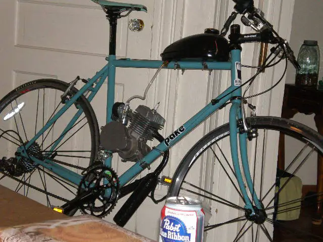

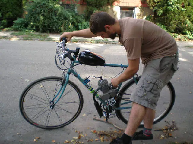

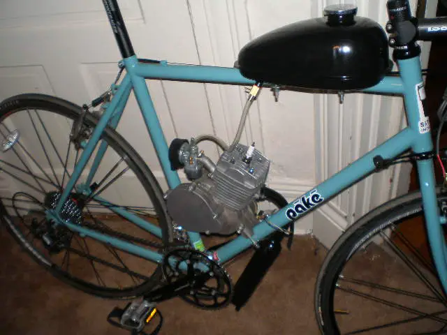

it is not a 29er but this is my first engine kit on a 700c cross bike, 700c and 29er's use the same size wheel with a different tire
the rear is 700x44 (about a 1.75)
works great
chris
ps 2 photos still have the road tire on the rear and I plan to change the front
also you can get a 700x38 road tire no problem ( about 1.55)

Wow what a good looking wheel size that is going to make a good looking Happy bike. Keep us posted I need to see this. Our moto X bikes used a large 21" front wheel for all the rolling reasons. The rear would have been that large but for the giant knobby. Have fun, Dave

wow, cool bikes, Hitekrdnk! that Pugsley is heavy-duty!
